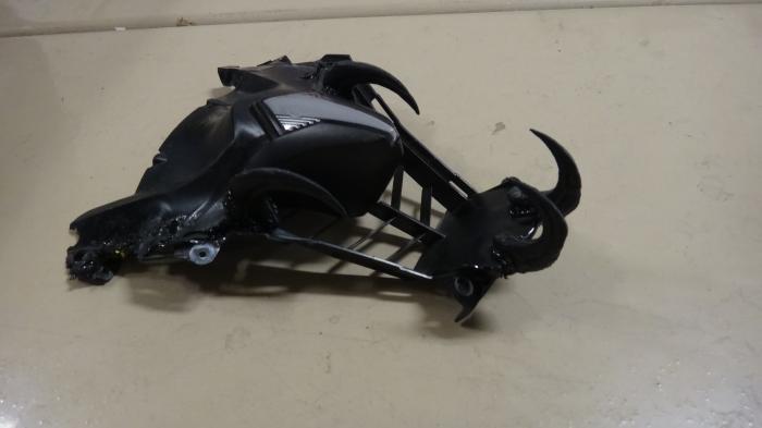

I've done all sorts of body work on my bike before but I really wish I had this thing when I started. You don't have to have mounds of shit that end up screwing up some bolt or body alignment and it's not the nasty pink or goop. Much more precision and it's a true bond. There is a learning curve but it's quick and easy so long as you heat mostly the rod, and a bit on the part with the 20/80 fanning rule.
I fixed all the broken little tabs that goop would have been a bitch to work with but these are strong, I can pick up the entire front headlight assembly of an R6 with a lil tab. I used some random 3d printed pieces I trimmed to fix to fix some missing chunks which worked out pretty well since I could use a heat gun to gently mold it to the same I wanted, trim it, then weld it.
For fun I asked the girl if she'd like some teeth on the front of the bike. After I showed her what they'd look like she was all for it and so for the fun of welding she's got a pretty vicious lookin bike now! Surely it added 10 HP too ;)

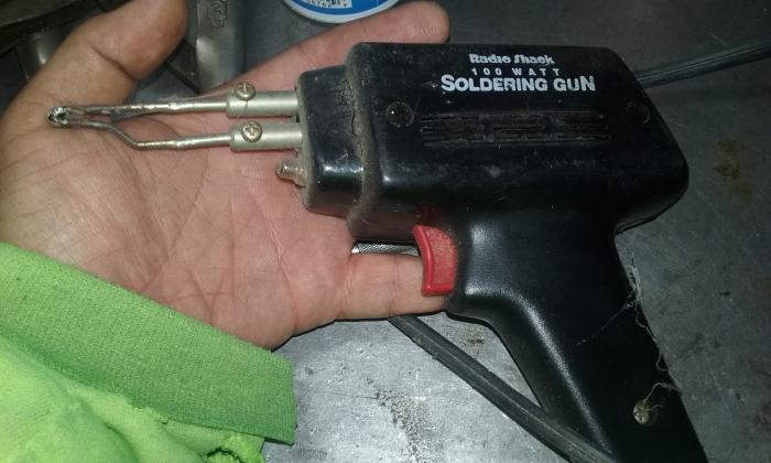

I jist paid $40 for this piece of dung about two weeks ago and its already leaking around the top edge. Its a bleeder valve for a 2000 dodge intrepid and it's a real bitch to change out, just like everything else on that lemon of a car. Its leaking around the top edge.....ever so slightly, directly in front of the bolt on the right side as evidenced by that white crusty crap. That's the reason why I changed out the last one which was leaking in front of the bolt on the left side. Is this a good candidate for welding with a soldering iron? If so then what do I use for filler? I'm worried that it's gonna blow out while I'm rolling down the road. These things are plastic, made in chineeze garbage. It's under 15 lbs of pressure before the radiator cap sends coolant to the overflow bottle. I just noticed this little gremlin today.
Also this is the only soldering iron that i have to work with. I'm poor until I find another job. If worse comes to worse then I can always put the other one back on. This car is a damn sight impossible to work on while on the side of the road and requires all manner of specialty tools and techniques. It's probably the biggest pain in the ass and worse design for an internal combustion engine in the history of automobile manufacturing.

To keep that soldering iron tip "clean" (you need to tin it man! :D I just learned how to do this after about 15 years of soldering... ) you might consider using some Al foil folded over a couple times and use it as a drag pad for the soldering tip on the plastic or you can use it to cover the tip. This might help with smoothing out and building up that flat surface with the soldering iron.

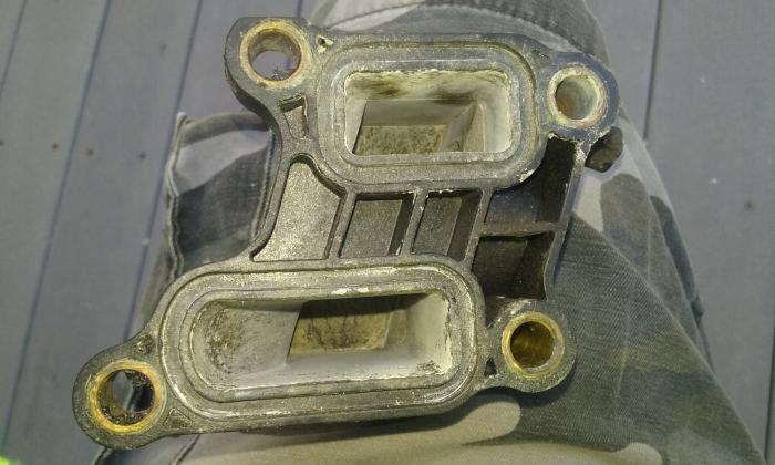

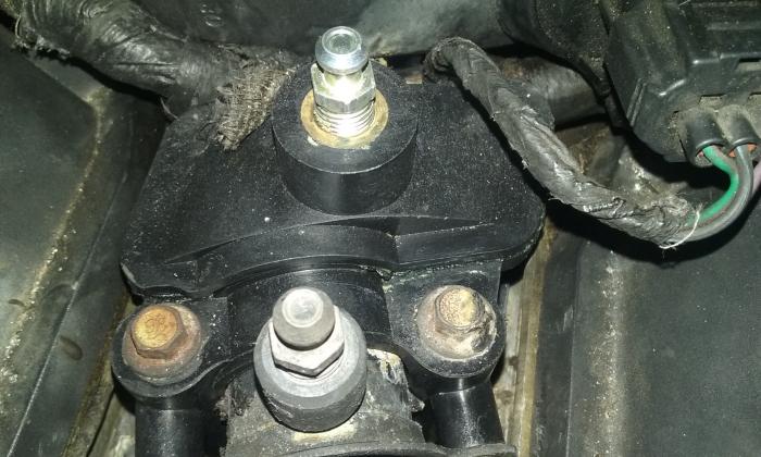

This piece mounts directly to the top side of the engine block. Top radiator hose is piped into it. The bolts have nothing to do with the leak. The problem is that it is molded in two pieces.....the body and a top cover similar to an AK47 receiver. Not sure how the top cover is attached but I don't believe that it is welded, probably some type of glue (made in chineeze crapola). The leaks are coming from the edge of the top cover because this is the weak point.
Here are some photos of the old piece. It looks like I can probably bond these two pieces together without filler since there is so much material to work with, then run some black RTV sealant around the inside. That top cover is 1/8" thick.

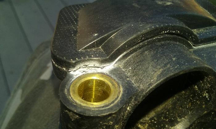

Side view. That big gap between the top cover and the body (just below my finger) is where they both developed leaks. $40 for this junk. That white crap in the crack is dried antifreeze.

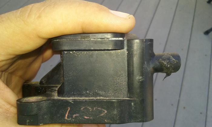

Where the leak is coming from. You can see how it has been escaping from the top cover due to a really crappy bond.

The halves of that part were either welded ultrasonically or with RF, with poor quality control. ABS does not solvent-weld well in tension, though it does quite well in shear. I agree this is a candidate for welding.
