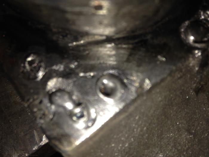

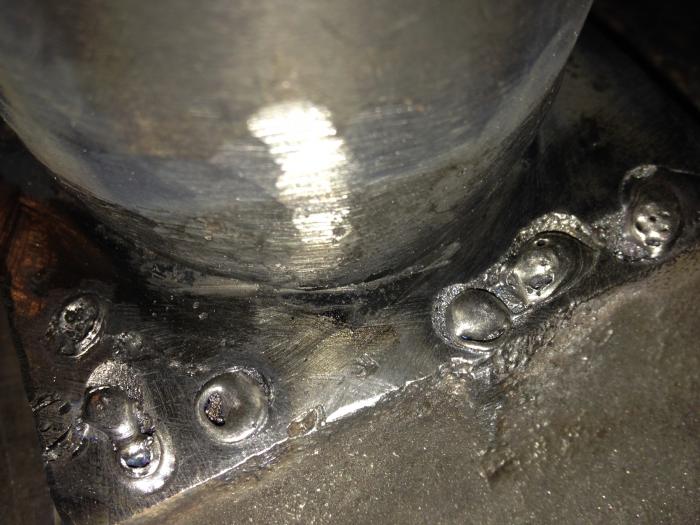

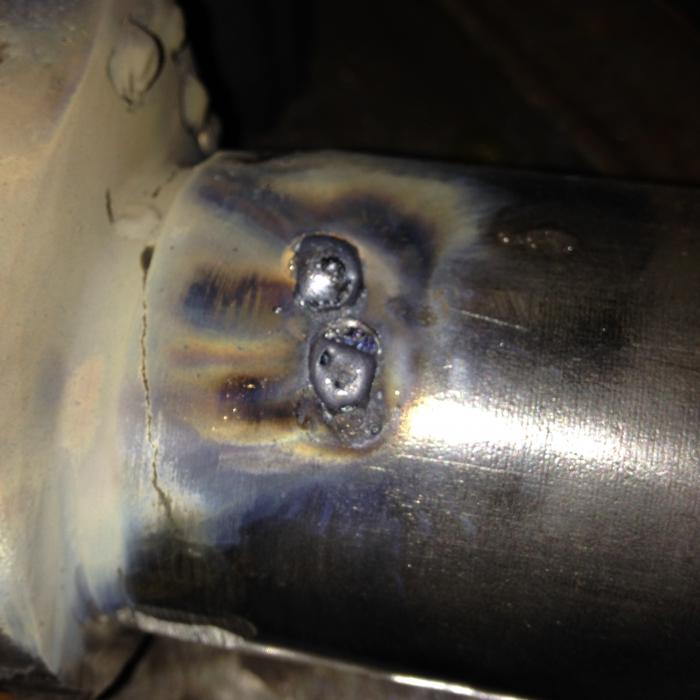

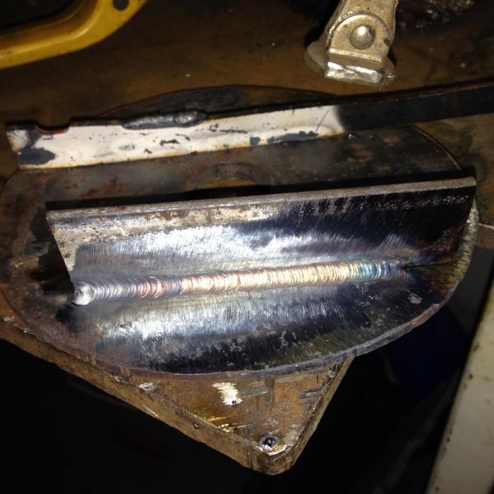

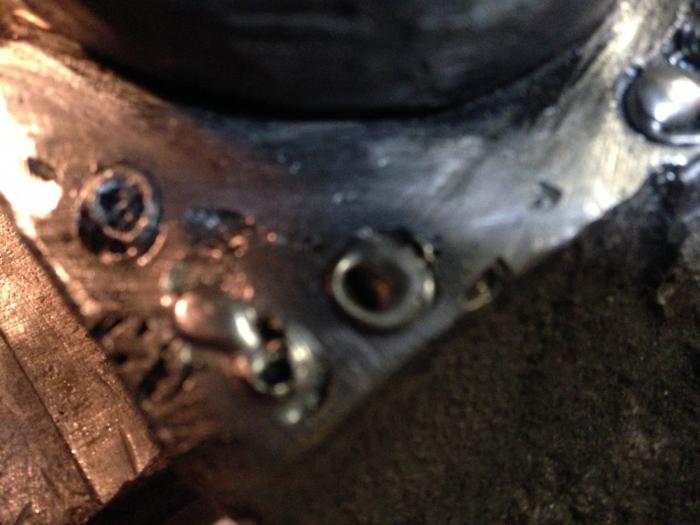

I took my tig torch at 135amps, and pop'd a tack and it gouged into the metal made all kinds of pitting and porosity,
I pop'd a on my other vice and is made a tack that was beautiful.
I also tacked up a filet and ran it same EVERYTHING and it came out ok.
Is the metal that crappy?
John~~

John,
If I am not mistaken that would be cast iron and the other vise cast steel.
