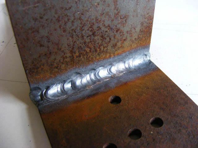

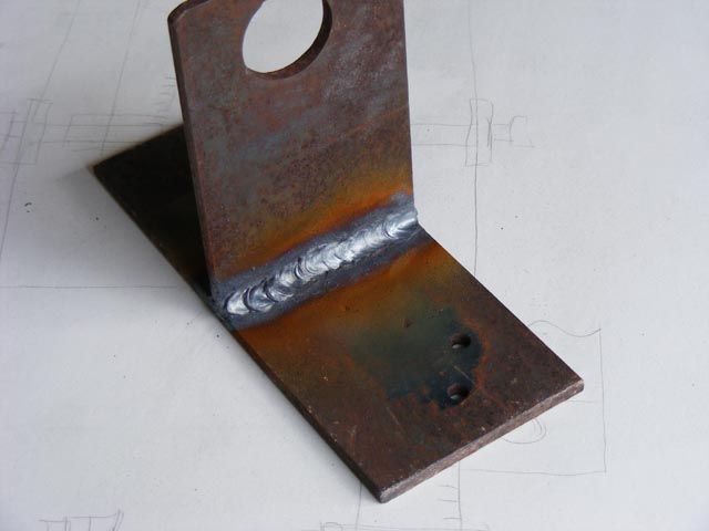

Hi, just a couple of welding jobs I did a couple of months back.
The first couple of photos are of a pair of brackets to attach my TV aerial to a post on my patio.
I used a bit of rusty old steel that I had in the scrap box, as at the time I was looking for something to put the 'Plaz through it's paces, and the aspect of not cleaning rust was something I wanted to try.
The steel plate is a piece about 50mm wide and 4mm thick.
Normally using conventional welding methods, like stick or Mig I get a lot of drama from daggy welds in the 90 deg corners, so the results which I'm very happy with are for you to judge.

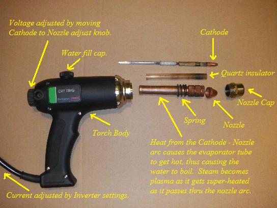

The Multiplaz works by creating an arc between the internal cathode and the nozzle. This causes the evaporator tube to heat up and the water to boil. Steam becomes plasma as it is forced to pass thru the arc while exiting the nozzle. Voltage is controlled by adjusting the distance between the cathode and nozzle. Current is controlled at the inverter settings. The system is relatively simple in design and it produces a lot of heat. The plasma gas acts as a shield gas when an arc is established between the nozzle and the work piece. The MultiPlaz is unlike any welder that I have ever used before. If you ever get the chance, try one before making any assumptions on performance. It is very unique as far as welders go.

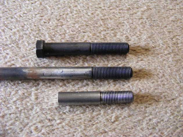

Hi all, one of the jobs I did some months ago was to butt weld an end onto a draw bar for my milling machine.
The end, which was 7/16 UNF thread had stretched and also partly stripped the threads, so I cut 50mm off of the end of the draw bar, bought a hi tensile steel hex bolt and cut it in half and butt welded the new thread end to the bar.
The ability to just tack the new part in 2 places to the bar end and then fully weld it all round without any distortion before cleaning it up was achieved quite easily. :D
There was no vee preperation to the butt joint, the two ends just being butted flush together.
Allignment of the two parts was on a flat surface with a piece of plate to maintain the side in line.
No clamping was used, just a piece of plate resting on top to hold the parts from moving whilst tacking.
When the weld was finished I kept the weld zone at red heat for a minute and let it cool slowly in some kitty litter and removed it after a couple of hours.
As the draw bar is going to be under a constant load holding Int 40 tooling in the mill spindle, I tested the strength by leaving it in the mill spindle while it was tightend hard for a few days.

Here are the two photos of the draw bar.
The first photo shows the new bolt, the old cut off piece and the welded bar.
The second photo shows the finished and file dressed bar ready to use.
