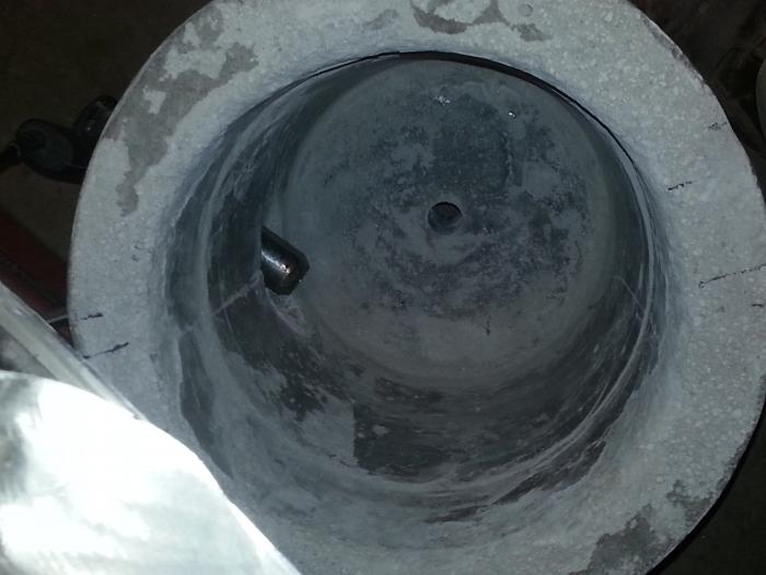

The refractory is from Redline in Chicago and is an excellent product but IMO contains too much coarse aggregate so that's why it doesn't finish well. I stripped out the walls and had a little spalling but no big deal. Right now I have a heat gun in the tuyere and have it up to about 170 to dry it out. I will probably let it sit for a week or so before I cure it. I have no experience in casting, only building furnaces so I am rather excited about that aspect of the process. The guy I am building this for is an absolute genius so between the 2 of us, and the on-line help, we should be ok. My friend works for a drilling outfit so I have 200lbs of powdered bentonite and 500lbs of fine silica sand on the way so I am pretty excited. I will eventually build my own furnace but this one is a great learning experience for me. And you're right, being able to weld and fabricate sure opens up a lot of doors into innovations. Thanks again for your links and I appreciate your feedback! 8-)

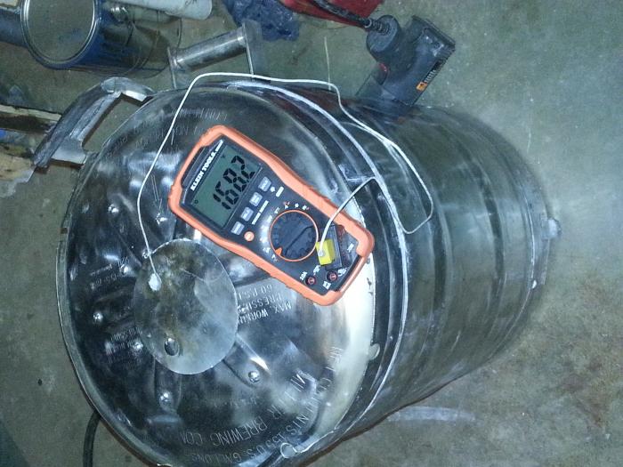

The drying temp and the inside. This stuff dries very unusually and the dark spots will all lighten out to the same color. The spalling is normal and most of the smooth finish will flake off when I cure it to 1880 degrees.

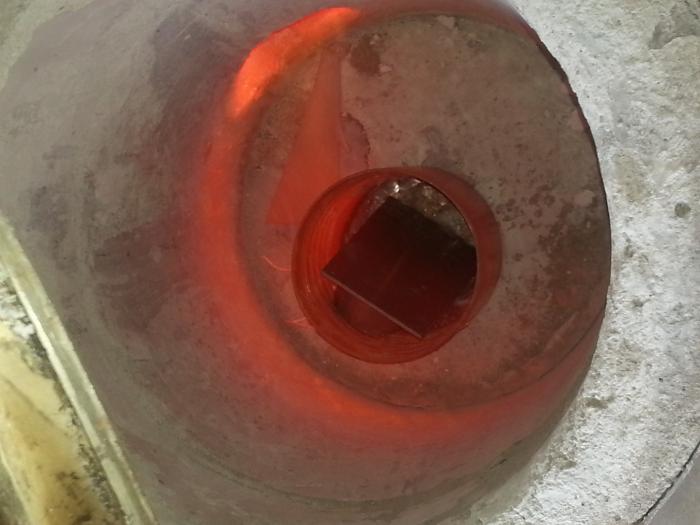

Got her cured and made a makeshift crucible and cast this little ingot this morning. She gets plenty hot.
Cool. Well, maybe HOT! What did you make the crucible out of? And what is the heat source fuel for this? Just curious as it does seem like it could come in handy for rough castings of aluminum. How much do you have in this build?
Thanks :)
