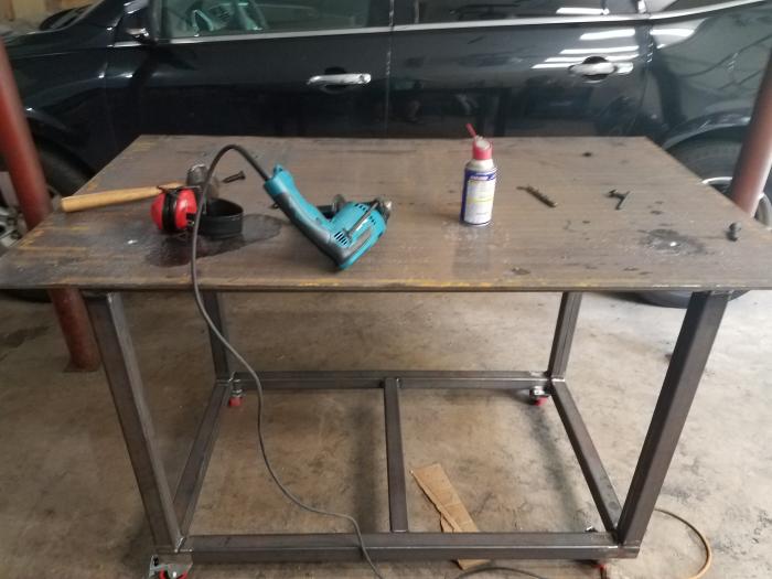

I bought and made my own 48"x72"x0.75" for under $500. A piece of 1/2" would be thick enough, but 5/8" is better. I used a Mag drill to drill the holes (took a while) and if you don't have one, you can rent one pretty cheap.
- IMG_0415.JPG (55.55 KiB) Viewed 3813 times
That's a lot of holes to drill!cj737 wrote:I bought and made my own 48"x72"x0.75" for under $500. A piece of 1/2" would be thick enough, but 5/8" is better. I used a Mag drill to drill the holes (took a while) and if you don't have one, you can rent one pretty cheap.

Make a table, it is good practice/a good learning experience. I made two recently. One is a sit down work station about 30x30 inches, 1/2 is a cutting surface and the other 1/2 is a really flat plate for welding on. The other table is a 3x5 foot table made of 2x2x1/8th inch square tube, and 3/8ths inch plate. The larger table cost the most, about $300 in materials. Welded them both up with my MIG welder.
- 20170205_205601.jpg (49.39 KiB) Viewed 3759 times
- 20170205_205612.jpg (53.04 KiB) Viewed 3759 times
- 20170806_145740.jpg (45.72 KiB) Viewed 3759 times
- 20170806_135354.jpg (48.29 KiB) Viewed 3759 times

Oh yeah, and both of these were done on my garage floor which is not level. Use a good framing square that you have proven to be square (lots of videos out there on how to do it). Don't over weld. You can get it as flat as you need it to be if you are careful. DON'T use a level unless you know for a fact you are working on a perfectly level surface. You don't need fancy corner clamps either. Tack it in one corner (Jody has videos on this), square it in one direction, put a second tack, and square it in the other direction. Lock it down with 4 tacks total. Watch the videos on weld correct weld sequence and weld it all up. Do not over weld. Heat distorts everything. You have to plan ahead for it.
Multimatic 255
That's why they make leveling casters...Louie1961 wrote:Oh yeah, and both of these were done on my garage floor which is not level. Use a good framing square that you have proven to be square (lots of videos out there on how to do it). Don't over weld. You can get it as flat as you need it to be if you are careful. DON'T use a level unless you know for a fact you are working on a perfectly level surface. You don't need fancy corner clamps either. Tack it in one corner (Jody has videos on this), square it in one direction, put a second tack, and square it in the other direction. Lock it down with 4 tacks total. Watch the videos on weld correct weld sequence and weld it all up. Do not over weld. Heat distorts everything. You have to plan ahead for it.
I defiantly will need casters on whatever table I make or buy. I've also been watching Craigslist to see if something pops up. Biggest problem is finding something I can wrestle around myself with just an engine hoist.
