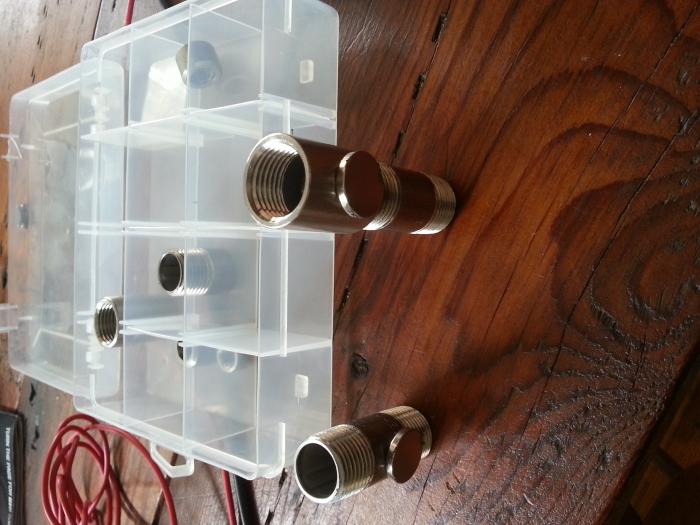

Kegs are done in an automated machine and I am betting in a 100% argon environment so they don't have to purge them and it makes no sense to normalize a lowly beer keg. I also dug this piece out of my scrap pile. It is 304 but welded with 347 filler and the welds are not magnetic neither is the piece. I have 8 strips of that 304 in the pic and every single one of them attracts a magnet pretty significantly. Also LtBadd posted a short video of 312 filler rod being attarcted to a magnet but I have a 4" 312 threaded cap for an environmental well screen that is non magnetic. WTF?Otto Nobedder wrote:I'll pose the question on the Welding and Materials forum on linkedin. There are several metallurgists there.

As you can see, the second reply supports Erich's statement about cold-forming producing martensite.
The first reply suggests to me that your beer keg may have intentionally been welded with an "overalloyed" filler, perhaps because ferrite and beer might not get along as one would wish?
The fittings you find that are or are not magnetic, the difference may be heat treatment after being drawn versus no heat treatment. I've encounter much Chinese 304 that is strongly magnetic, and I suspect the price reflects not annealing the finished part.
Well there we have it. I never really gave two chits about whether my SS was magnetic and never thought to check before but it is a really interesting metal and gosh it welds nice but I have been ingrained to think all SS is non-magnetic when in reality it's not. Thanks China! Thanks for getting the info Steve.Otto Nobedder wrote:As you can see, the second reply supports Erich's statement about cold-forming producing martensite.
