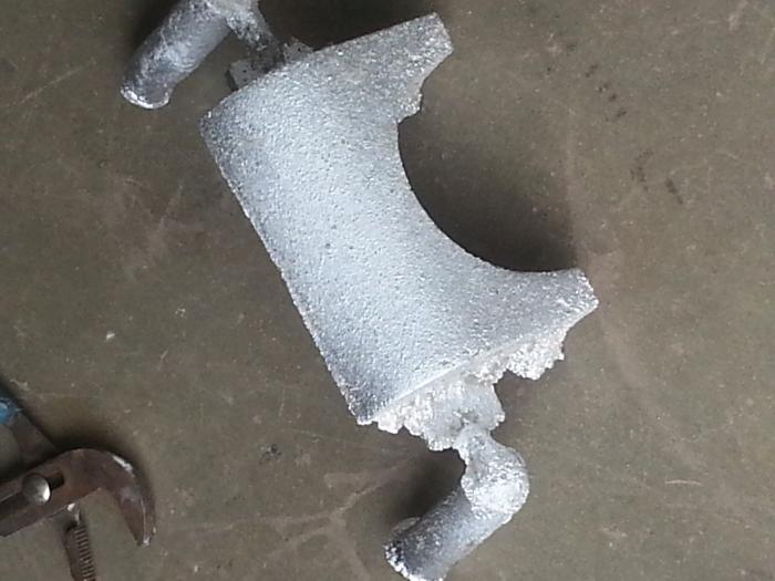

Fresh out of the mold and then cleaned up to go to machining. This is a custom pool table corner. I supplied the rough core and now my friend is going to machine it down to the final rendering to make it a bit easier to cast and easy to clean up on the mill. For my first casting, I am pretty proud of it. It's not as easy as it looks.

excellent results for try number 1!

I watched hours of YT videos, read all I could find about casting. Without that help, it may have been another story but I am quite pleased with the results. I spent about 4 hours last night just practicing setting up molds. I am actually getting pretty good at it. I played with the moisture content of my sand a little and tweaked my flask a bit and I am itching to burn again soon. I can see this becoming very addictive. Thanks for the compliment!

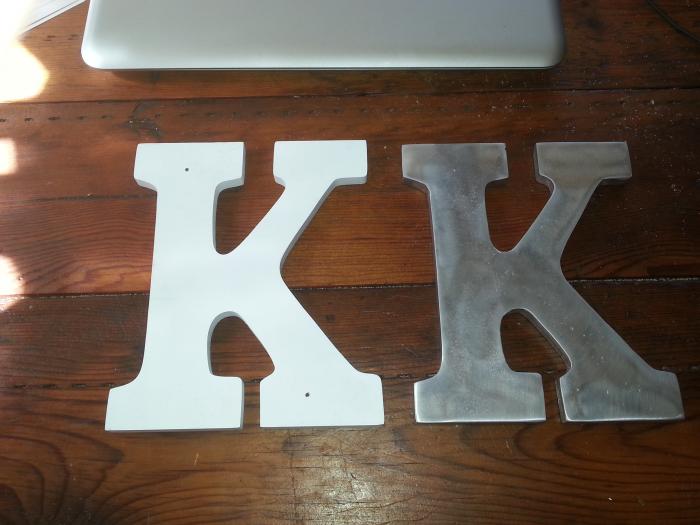

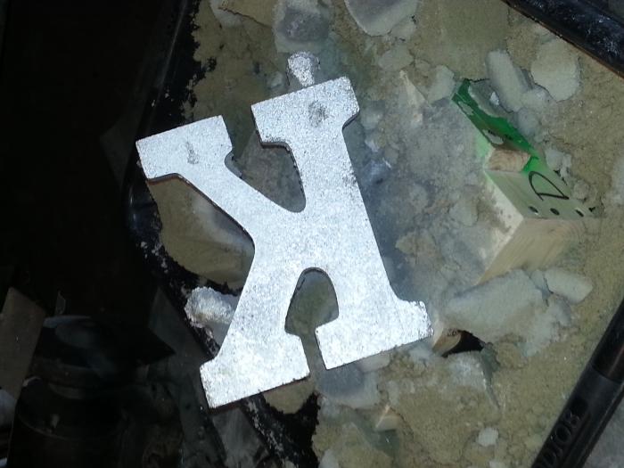

My second shot at it. I'm pretty happy with it but I need facing sand for a cleaner finish. Second pic is cleaned up next to the pattern.

Well done Jeff. That K looks super.
Did you cast more than one of the first part?
Making extra pieces to cut and check for porosity can avoid unpleasant surprises when machining.
Im not a pattern maker but for such thick part the gating looks a bit small. Or did you cut some of it away?

Hey Anders...thanks! The first part is an obsolete pool table corner that my friend wants to bring back to life and use on his custom tables. In the form it was in, it wasn't partable so I had to modify it with oil based clay to be able to cast it. After it was cast, he took it and it machining it down to make it easy for me to cast and easy for him to clean them up on his mill so we will see if there is any porosity when he works on it. The gating looks small because my flask was almost too small for the part so I had to make do but it came out good with absolutely no shrinkage.My goal is, when I get the part back from him, to cast several copies in resin so I can cast multiples at a time. All the shrinkage was in the sprue like it was supposed to be. As you know I am just getting started at this and there is much to learn and I was itching to cast again so I made up that K for my wife. It was old diamond plate from a trailer I scrapped. It came out with very sharp edges and very few holes and the finish is ok but I know I can do better. About 20 minutes with the angle grinder and it cleaned up nice. If you have any tips for me, I am all ears at this point. I really only got into this because I want to cast those table corners...you wouldn't believe what he can get for a set of 6 of them...haven't been made in 40 years...until now 8-)

I have no hands on experience from the pouring but have been involved in a lot of casting development the past 20 years. Visited a foundry last week that just did the first samples of my latest project. The risers and ingot had almost the same volume as the actual parts.
The trick is to control the solidification so the gating remains liquid after the part solidifies. Lots of trial and error even for the pro's still.
Not unusual to have perfect outer shape (solidifies first normally) but inside can be like a Swiss cheese if gating is to small. Might not be critical with some porosity but the ones I work with must be pressure tight.
If you plan to powder coat you have to reduce porosity under the surface otherwise you can get blisters when part is heated.
