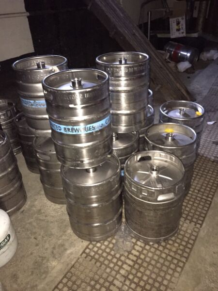

I was looking a back in November or so for kegs for this. I found someone selling them in Sydney on ebay for 80 each. Seemed reasonable, I don't know what they are worth but I supposed to a homebrewer thats a pretty good price?
Anyway, found a guy today on Gumtree. Has about 10. Wants $20 each for them. I might buy 5 or even the whole lot. Make some BBQ's out of them and sell them. Gotta be some other good uses for them. Not sure why they are for sale, when do they cease being suitable for beer? Photo looks like the back dock of a club or pub.

I do quite a bit of keg modding for homebrewers. Some of them will only use brand new kegs while others will use aged ones. If you can find kegs cheap...grab them. You can always turn around and resell them for some extra beer money and they will never go down in value so I always have a few laying around. The guy I am building this furnace for was thrilled to know I had a keg for his project and the means to get the job done. Homebrewers, especially new ones, will spend money freely to get up to speed with their colleagues and not look like a noob. I don't know when/why they retire kegs..maybe when they get dented up really bad and the metals strength might be comprimised. Grab those kegs...thats a deal!Rupes wrote:I was looking a back in November or so for kegs for this. I found someone selling them in Sydney on ebay for 80 each. Seemed reasonable, I don't know what they are worth but I supposed to a homebrewer thats a pretty good price?
I'd run the serial #s past any listed/stamped owner/distributor on the kegs, to be sure I wasn't buying a "hot property", so to speak. That price is remarkable, to say the least. I think I paid a bigger deposit than that on the last keg of beer I bought for a party 30 years ago.
...always wise to cover one's behind...
Worst case, you might get a finder's fee if you do the legwork to confirm whether or not the sale is legal.

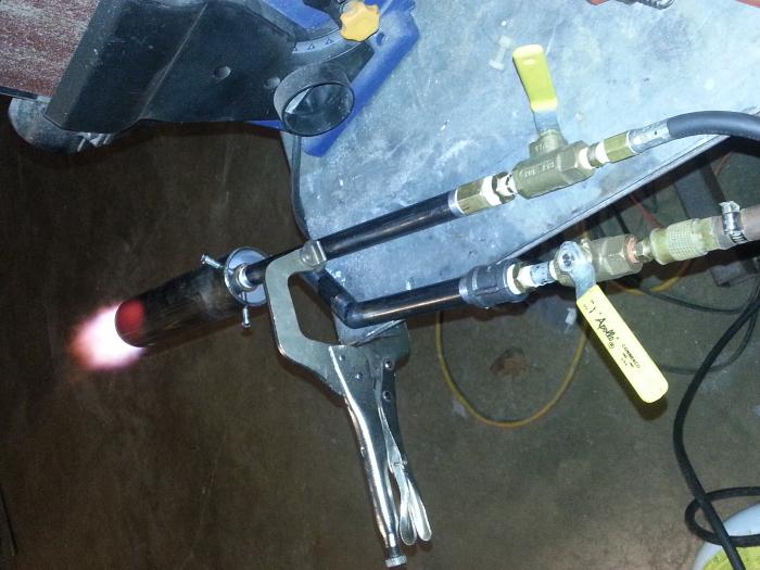

I've seen them on Kijiji in Calgary for $20 / 25 bucks, I've been thinking about using one on its side for a forge setup.
- 20170131_154814.jpg (60.49 KiB) Viewed 2550 times
- 20170201_134128.jpg (52.01 KiB) Viewed 2543 times
Artie F. Emm
- Artie F. Emm
What fuel are you using? I have been looking into this for a project, and have been considering a waste oil burner. The web has a wide range of ideas on the topic.

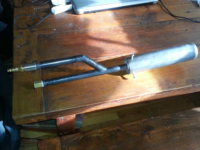

If you don't mind a newbie question: how does your burner work? Do you mind showing an exploded view?

- 20170201_151027.jpg (53.31 KiB) Viewed 2536 times

Looks good! If you want to control the gas flow get a regulator or use the ball valve but I wouldn't change it until seeing how it runs in the furnace.
