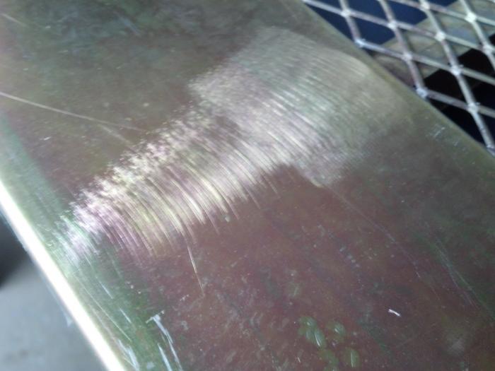

I am new to welding, having taken it up as a hobby. I am using a Lincoln Electric 125HD, Flux Core. I need a welding table. I ordered a Klutch from Northern Tool and as you can see in the photographs it left allot to be desired upon arrival. It arrived last week and going back tomorrow. The photograph shows but one of seven such marrings on this table.
Can someone recommend a decent welding table for relatively short money? I don't need on larger than, say, 48 L x 21 W x 36 H.
Until such time as I can get a welding table what can I weld on? Any advice greatly appreciated!

Ultimately the purpose will be to repair items that are in need of repair. Nothing heavy duty.
I do not need certified flatness. That answers a question I've had about why some tables are in the $4K price range I would assume. If I can locate as you did a sheet of 3mm steel I'll be happy as it will more than suffice for now. Just not sure where to acquire it. Even tables on, say, Craigslist, are very expensive.
I was livid when I saw the condition of that Klutch table. It would have been for the most part fine for now but apparently you get what you pay for :-/

I'm no expert, but given that your needs for now seem pretty modest (...don't require certified flat, using for general repairs, etc...) are scratches on the table that you got really a deal-breaker? I understand you would like something that you purchase new to arrive in pristine condition, but a welding table will take a certain amount of abuse by design. Maybe Northern will give you a partial refund or something if you ask.
