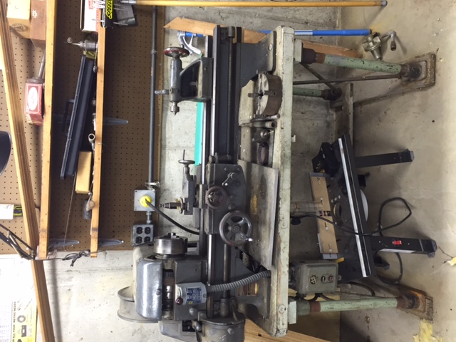

- 1947 Logan Lathe.JPG (128.47 KiB) Viewed 2674 times
I have a high-end tool store a couple miles away and I do a "walk through" from time to time and I am in the same boat...Lots of new goodies I would love to have but I already have the beat-up version that's paid for.Tom Osselton wrote:I've got my fathers Clausing in the basement and a Atlas in the garage that was my grandfathers I haven't bought mine yet!
It's strange but I can finally walk through the tool departments and not see something I need it's disturbing!!
- 20161201_134209.jpg (78.9 KiB) Viewed 2674 times
Tom Osselton
- Tom Osselton
Location:Calgary Alberta
Looks like your almost there! I'd love to have one with the taper attachment but I haven't found one yet.
You did all that in one day? Wow! That was quick. Looking good.exnailpounder wrote:20161201_134209.jpgHere is my lathe after I tore it down to parts, stripped off the old paint, re-painted it and started putting it back together. The paint is as close to the 1947 original color as I could get but the flash makes it look like Ford blue but it is actually very dark. I love refurbishing great old equipment. I'll send a couple more when I get her running again.
Location:Orlando FL
Hey Jeff, I like that straight edge you have leaning against the shelf, comes in handy.exnailpounder wrote: Here is my lathe after I tore it down to parts, stripped off the old paint, re-painted it and started putting it back together. The paint is as close to the 1947 original color as I could get but the flash makes it look like Ford blue but it is actually very dark. I love refurbishing great old equipment. I'll send a couple more when I get her running again.
No Craig...just an old table. It's actually very well made and thick but I'll overbuild it so it's steady.motox wrote:jeff
did it come with a set of cast legs?
LOL...now you guys get to look around my shop a little bitLtBadd wrote:Hey Jeff, I like that straight edge you have leaning against the shelf, comes in handy.exnailpounder wrote: Here is my lathe after I tore it down to parts, stripped off the old paint, re-painted it and started putting it back together. The paint is as close to the 1947 original color as I could get but the flash makes it look like Ford blue but it is actually very dark. I love refurbishing great old equipment. I'll send a couple more when I get her running again.

The purpose of leveling a lathe is to ensure that both
ways run as perfectly parallel as possible with each other in the
vertical plane, and has little to do with 'level' with respect to
gravity. If the front or back way is slightly higher or lower than
the other one, it doesn't matter as long as the deviation is constant
from one end of the machine to the other.
jeff borrow a level from one of your machinist
buddies if you do not have one. carpenters
level is not accurate enough. get it within
.0005 over 8"s. length first the width.

This is step one. Then you need to turn 2 diameters on a foot long rod shaped like a barbell- bigger on the ends.motox wrote:The purpose of leveling a lathe is to ensure that both
Turn one end then move to the other WITHOUT moving the tool in or out and turn the other end. Measure with a micrometer and if both are the same diameter, your lathe is good, if one is bigger than the other your bed is twisted and needs adjustment. This is assuming your tailstock is adjusted to the head stock, center to center
