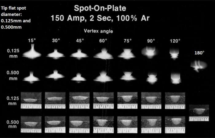

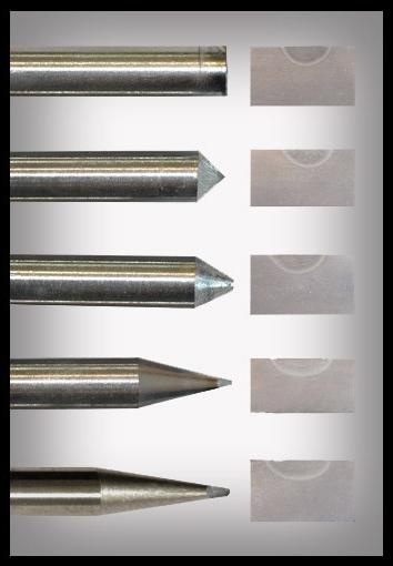

Here is some grinding information - might help you out if you don't already know this stuff.
Also, in general, with a given grind angle, the larger the flat spot ground on the tip, the more penetration.
That's what the 2nd pic is showing with the 0.125mm and 0.500mm slides.

Dave, thanks for the info. I copied it to my hard drive.MinnesotaDave wrote:Here is some grinding information - might help you out if you don't already know this stuff.

Photo taking HINT: when taking pics and you can't get the camera to focus because the object is too close, place something behind the object of interest. Take a look at this (showing off my awesome tungsten sharpening skills as well
Dave, I have combined those tungsten sharpening angle depictions into one picture, so that way you don't have to post several, just save this one, and it has all of them:
