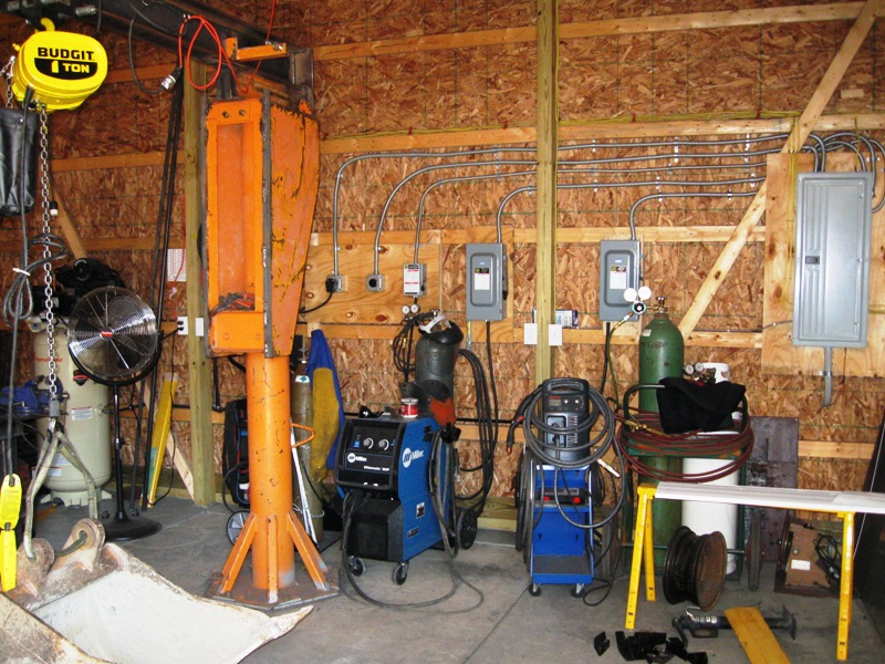

It is good that you have 3 phase. 3 phase equipment is a lot cheaper if you ever plan on getting more. Have a couple of questions. What is the amperage on the 3 phase service entrance panel? Have you thought of using a 60 amp load center instead of a 60 amp safety swith? You can find a load center alot cheaper than the safety disconnect and they accomplish the same thing. Is it just going to be the hobart welder and the plasma cutter you are hooking up? Oh, is there gonna be any county inspectors involved in this? Here is a link for choosing a plug and receptacle. If you go more than 60 amps then you will have to use an industrial type or hard wire it into the box.http://www.stayonline.com/reference-nem ... blade.aspx.
This is what I did in my shop, but I didn't need the ability to unplug my plasma cutter so I hard wired it.

Nice clean shop Jim--very nice! That's a nice crane and hoist set-up you have there. Someone has been tempting me to buy a gantry crane recently, but thankfully, it's too big to go in my shop and I don't know where it would reside outside either--it's a big yellow thing--looks like Big Bird. I'm not sure of the amps at the panel, but it's a big panel that serves my compressor, large woodworking machines, and dust collector motor. I probably want a fusible safety switch so I can cut off the power each day because one of the outlets will be outside, but I'll check into the load center option. There is an abundance of disconnect boxes on Ebay--already low-bid on a couple. After getting up to speed on the plug/receptacle options from an old Grainger catalog and asking my electrician a few questions, I've decided to go with some 60amp pin-and-sleeve components. I never would have done that except that I found everything on Ebay--even with all the shipping charges, the savings will be nearly 70-80% compared to new. Later, I'm going to look for another set on Ebay that will work for a 100amp, single-phase circuit, so I'll check out that link before taking any action with that--thanks. I shouldn't have any problem with inspections--the city of Houston can be a real pain if they catch wind of anything, but I've never heard of any county problems in this region.
As far as I know, I'll only be using a plasma cutter or a welder. There are already outlets for the Hobart 175 MIG--might need to run a bigger circuit depending on what welders I acquire in the future. I'm keeping an eye out for a nice TIG--trying to follow Jody's advice--missed out on a Syncrowave 250 recently that was close enough to Houston for local pickup, but the seller's Ebay rating was questionable--bid low and lost. We all are hungry for sound advice from experts, but when they give it publicly as Jody so generously does, the products they recommend become more scarce and expensive. Oh well.... I almost bought an Everlast 80amp plasma cutter and a PowerTIG 250ex--was right on the edge, but after asking about some nitty gritty details and giving them a chance to "Sweetin' the Deal" a bit, I became disenchanted and decided against it--still don't know about the TIG. I see a lot of other interesting welders on Ebay and Craigslist, but don't understand all the ins and outs of each model--what they are for, who they are for. There surely must be a bigger range of good choices out there than what I'm currently aware of.

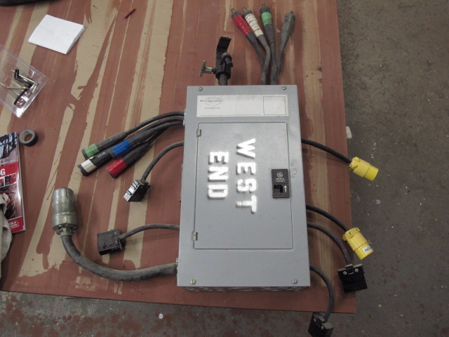

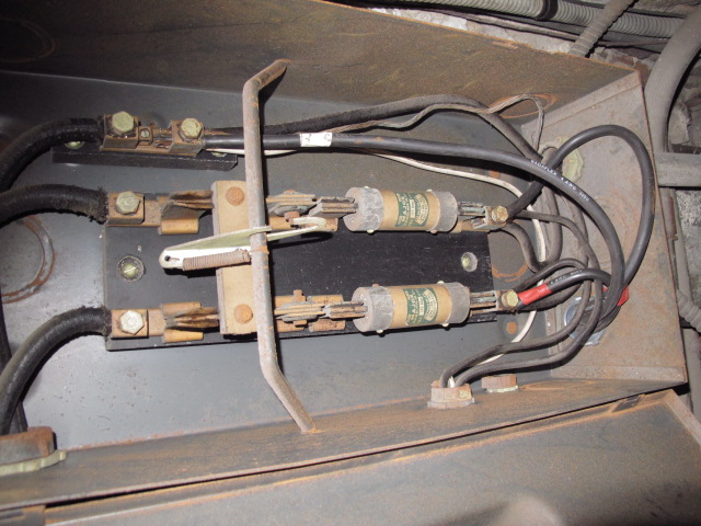

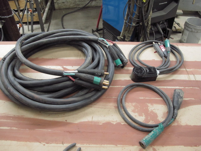

Here's what I did for my power. Note it's all "temporary" so I can move it to wherever I need it. The 3 phase machines are all hard wired into a phase shifter.
I tied in four #2 welding cable pigtails to one of our main fuse boxes. From there it runs about 25" and twofers (splits) into 2 diferent 220 4 wire 150 amp distribution boxes. I also have two 50' 6/4 SO extension cords or can use welding cable for longer power distances. Everything uses the same type plug so it is all interchangable. If I need to go on a job site, I can pack everything up and tie into any power supply with the heavy duty alligator clips that adapt into LC-10 connectors. If I get fired or move, I can also pack up all my power supplies since they aren't hard wired into the wall. That's the nicest thing about it being temporary. The hard part is the cost of all the connectors and adaptors, but I did it over time and tried to find whatever I could on sale or closeout.
adapters x cable and alligator clip
distribution box
distribution box
pigtails from main fuse box
WeldingSyncrowave 250,Millermatic 252,30a Spoolgun Cutting12" Hi-speed Cutoff Saw, 9x 12 Horizontal Bandsaw MillingGorton 8d Vertical Mill TurningMonarch EE Precision Lathe GrindingBrown & Sharpe #5 Surface Grinder

Hi Delraydella,
Thanks for all information, photos, and effort. Your setup is very intriguing. I'm not yet totally clear how it all works together, but I've only looked it over in the last few minutes. I'll study it some more, and show it to a friend who is more knowledgeable about electricity--maybe he can clarify some of the details. Give me some time--I'll ask questions later if I still have any. Thanks again.
