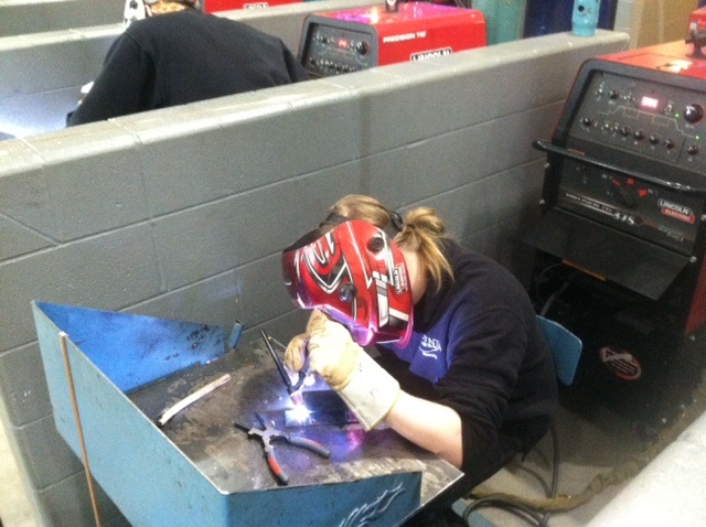

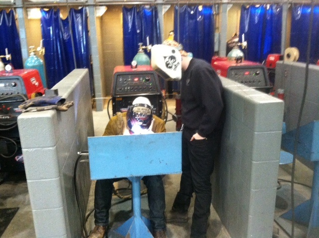

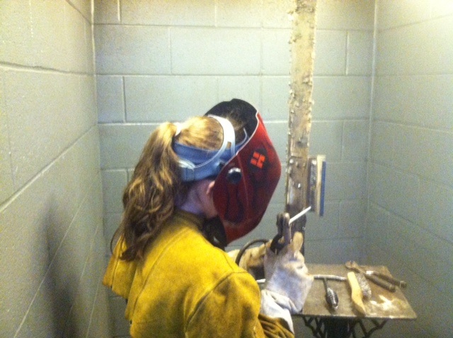

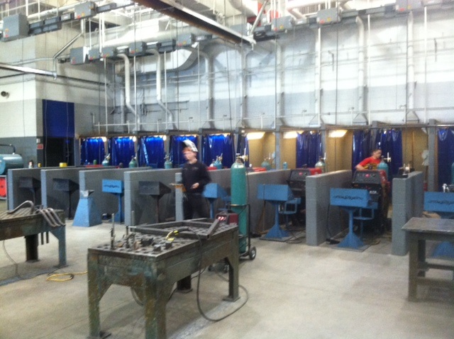

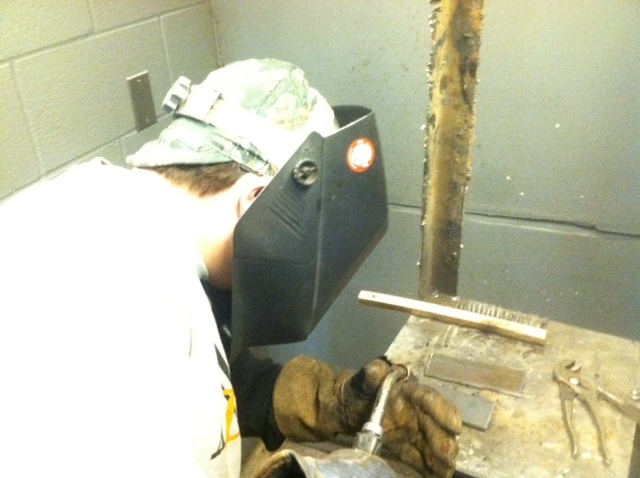

Here are some random pics of some of the Seniors.
- image.jpg (106.42 KiB) Viewed 1540 times

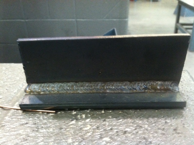

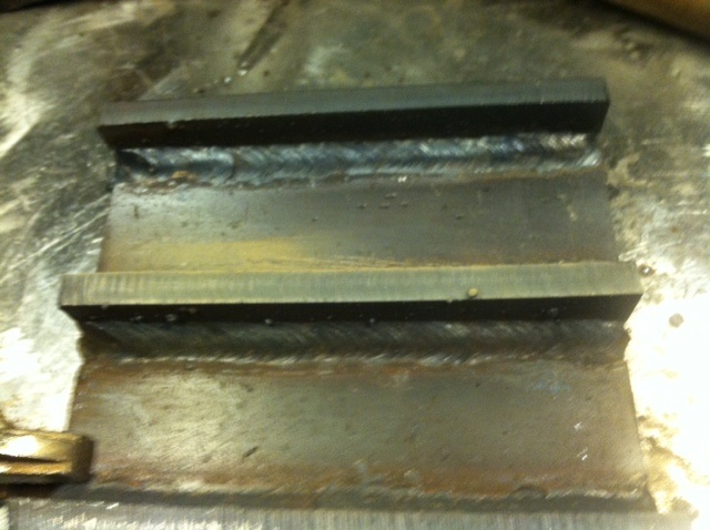

Some of their welds. Quite impressive given their arc hours.

hillbilly welder wrote:It's the Welder that make the difference not the machine. In time when your old enough you will understand this TonyAKweldshop wrote:Nice pics Jon.
I can tell that school is the real deal, just look at all them Lincolns.

Just to clarify the students running horizontal 7018 are really not weaving but using a slight side to side oscillation in the puddle. The purpose of this as Jonathan said is to teach the students to control width and increase the likelihood of undercut from a long arc and having unequal legs. Let’s face it running a horizontal fillet is not that difficult. Having them increase the leg size with oscillation forces them to learn how to deal with undercut and unequal legs, skills that will help them as the tasks become more difficult and when they move into different processes as well. Everything I have them do has a specific purpose beyond having to weld in the easiest position first.
Here is an example of a student who can make a nice weld but I have challenged him to make it bigger just so he learns how to do it should that situation arise someday. The results of the larger weld were not as nice but I failed to take a picture.
