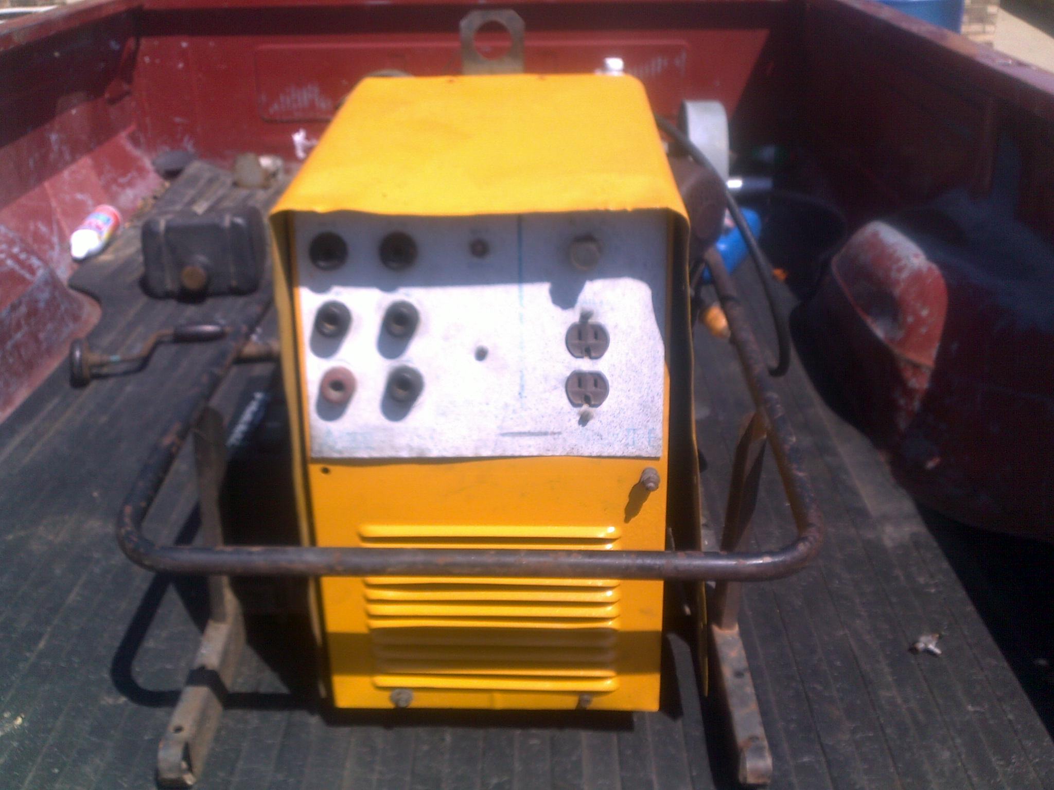

hey guys, this my first post here, i recently was given an old welding machine and needed some info on it as i couldnt find much about it online, its an airco welder/generator, the serial and model numbers are worn off it so i cant provide any info there, it has only 2 110v outlets (no 220v outlets) and a kohler 12hp engine, it didnt come with any leads but it takes some sort of small pin lead to plug into the machine, and it has several plug ins for the leads and each plug in has different amp settings written above it, its not running but i already bought some fuel lines, fuel filter, and air filter, and im gonna make an aluminum gas tank for it since the original is completely rusted, im really excited about this as its my first ever welding machine, thanks in advance!

ill try to upload some, i got it running yesterday since i didnt have to work and got a can of spray paint to make it a little more appealing till i can fully restore it

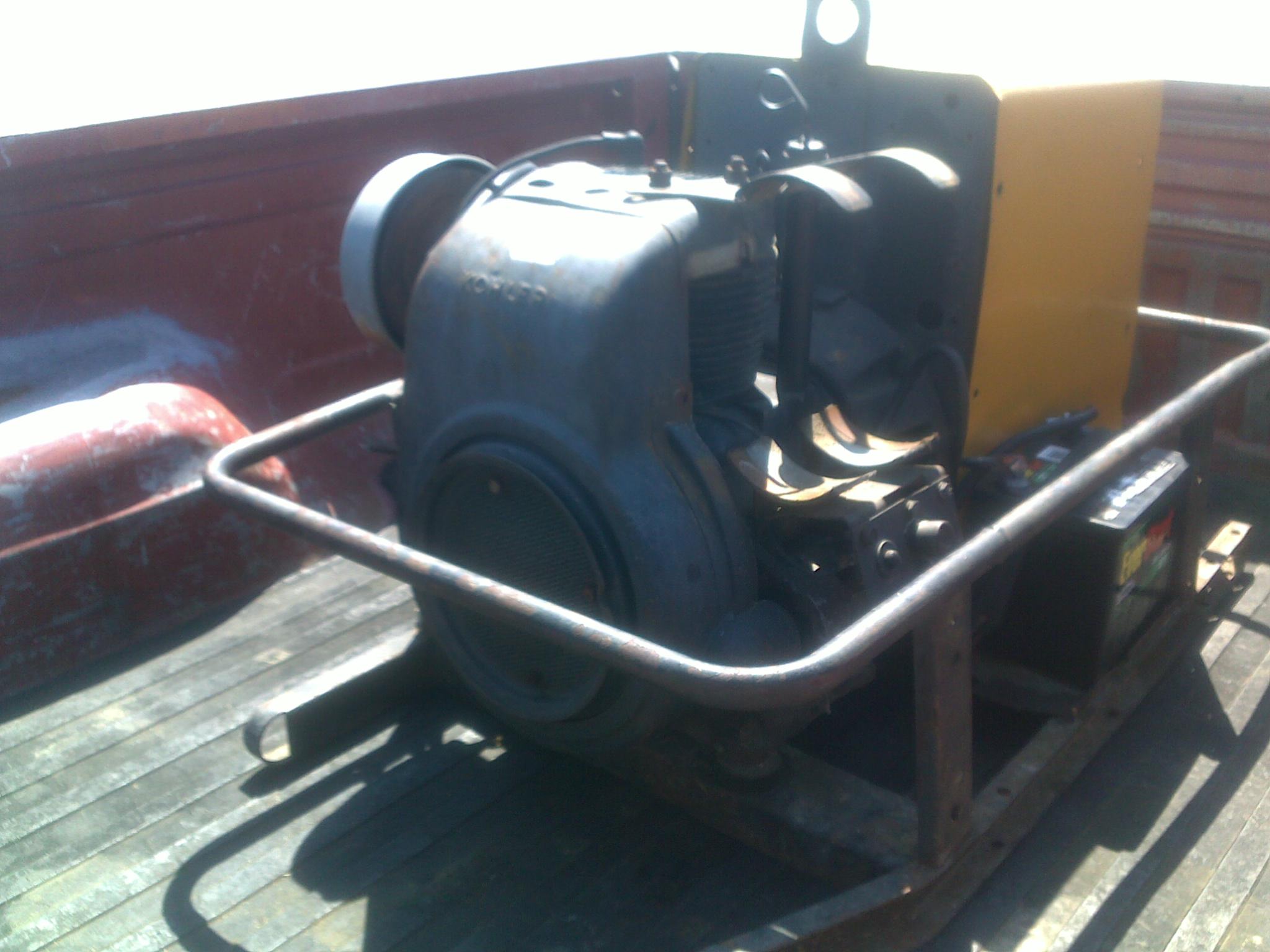

these are the pictures i took the other day, if you need more just let me know

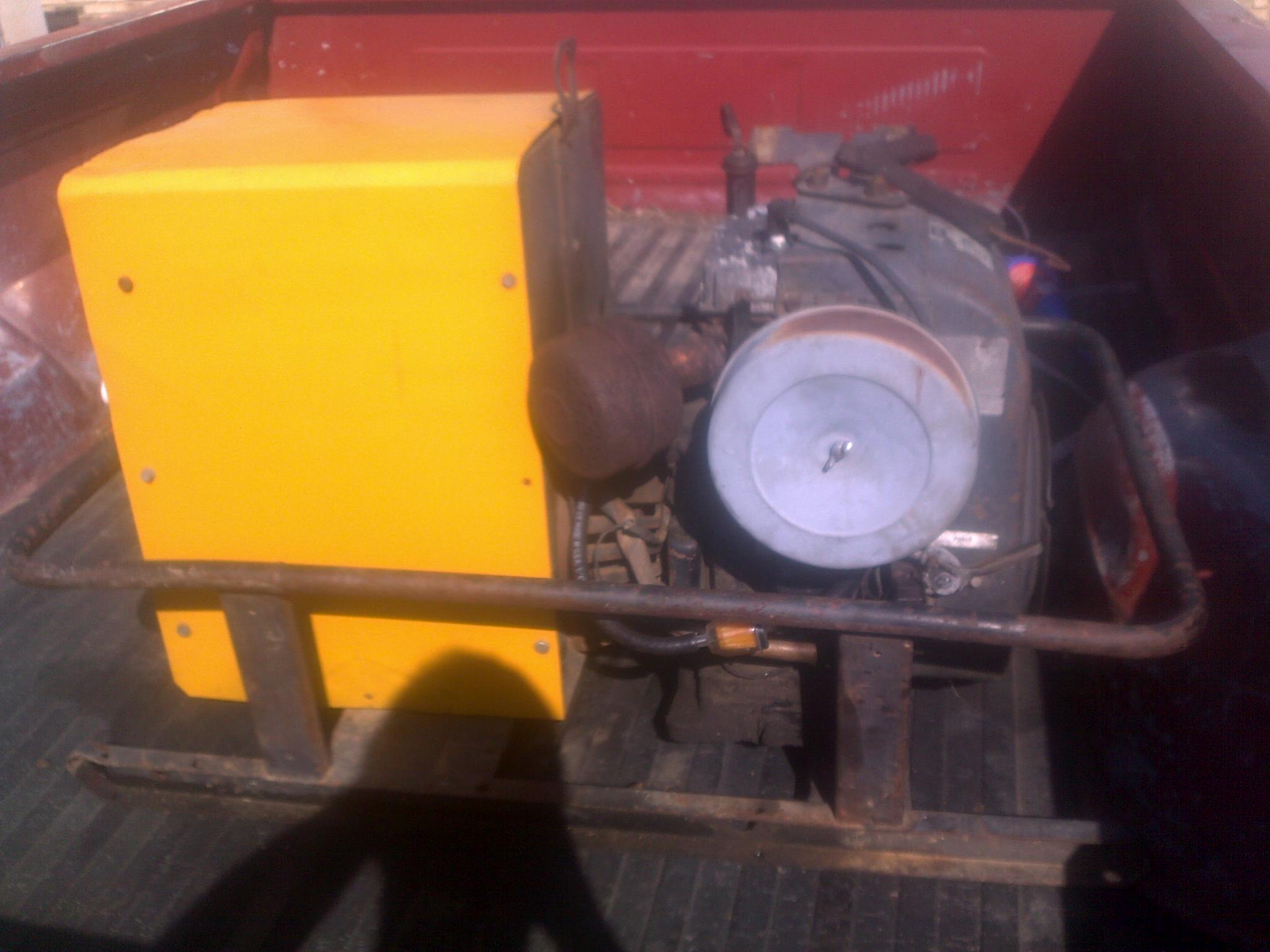

here are some more pics, sorry if the resolution isnt good, i only have a camera on my phone, and i tried getting a more up close pic, but it just ended up turing really blurry

HI i have an old miller motor generator welder very much like that, those type of weders are usally great stick welders because of the motor drive, they have great basement power meaning that you can run 1/8 inch 7018 nice and hot and hold the arc really tight. without having the transformer
cut out or get weak like some plug in types might do. so dont let the old exterior fool you, that type of machine can be one of the best stick welders. OK from looking at the pics here is what is going on, It is a DC machine and the red plug is your stinger connection: and all the black plugs are different amp ranges that the ground plugs into,,now this is the weird part that is usally done the other way around but try it the way I mentioned and if the arc is very forcefull ,then plug the ground into the red and the stinger into the black plug,, oh yeah the knob on the right is your fine amperage controll it will give you full controll over what ever range plug you are plugged into however: it is best to match your range plug setting as close to your application as possible, as it makes for the smoothest welding , oh yea since there is the possibility that something is not quite right ,,for your first tests use a plain old 100 watt AC light bulb to test the weld current by touching the ground to the outer screw part and the stinger to the middle button or vise versa it works the same either way,, and it should light up fairly bright. anyway this is a safe first test as it cannot hurt the electricals in your welder if something is hooked up wrong;) Ps. the worst thing that can happen with this method is that the bulb can turn into a fuse and burn out in a flash "witch I have never seen happen " or nothing at all that means back to the drawing board..you will have to play around with the range plugs and re label them from cool to hot and if you are really in luck somebody you know might have the right meter so you can know the actuall amperages for them
