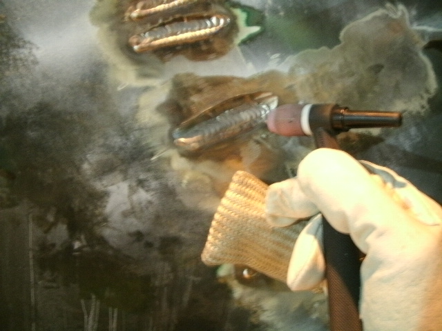

The broad surface (I have two fingers in it) makes a stable prop on flat(ish) surfaces. There are probably 14 passes in the weld shown at this point, and I paused to cool only to protect the metal, not my fingers.

I was getting by fine with the standard tig finger, but when you're going flat out at high amps it helps to have a heavier welding glove or gauntlet on your torch hand to prevent the rest of your hand from smokin. The standard tig finger does not fit over my gauntlets, but the Tig Finger XL does. Perfect!!!
No more restarts to let your hand cool off!
Not necessary to have any special foil backed gloves etc.

I hadn't thought about it fitting over serious heavy gloves... And I've been washing out welds with the plasma cutter, which COOKS gloves...

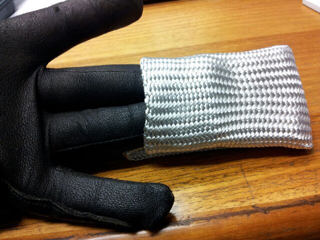

Ah, I get it...
The XL will fit two fingers just fine on lighter gloves, as seen in my original post, which I guess is what you meant by, "I wish I could do that."

... Not sure about getting two fingers in the XL until it loosens-up a bit... sorta tight on two fingers w/o gloves... The standard TIG finger was very stiff, took a bit of work to soften enough to get a finger in it.

If you can't get two bare fingers in the XL, you either have huge hands (I stretch XL gloves), or you were shipped the wrong thing. I've posted pictures of my gloved hand with two fingers in, and my suggestion to Jody was to have a friction-tape liner to keep it from slipping off.GlenC wrote:TIG fingers arrived today!... Not sure about getting two fingers in the XL until it loosens-up a bit... sorta tight on two fingers w/o gloves... The standard TIG finger was very stiff, took a bit of work to soften enough to get a finger in it.
