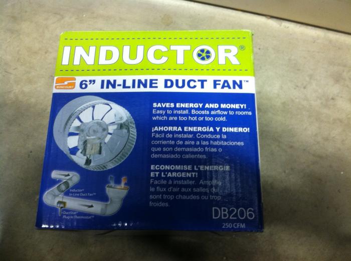

I am putting pieces together to make a fume extractor that will simply vent outside
I started a thread in the metal cutting section and will be posting progress there. I also will be building a down draft table, when I get some free time set aside.
I do not feel that you would spend a whole lot of money if you have the skills to make one and don't need the fancies that come on the real ones.
Below us a fan that I think I will use in the hood.

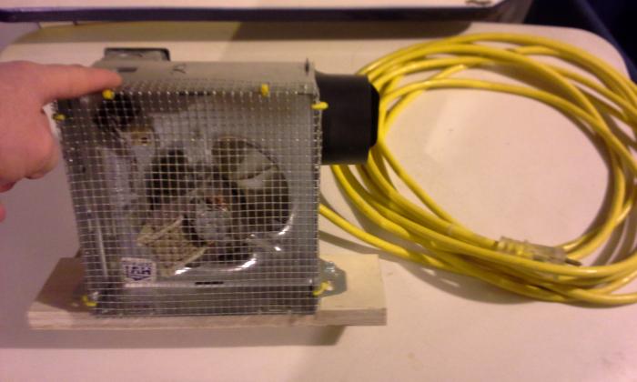

Gundog, Here is a little fan I put together for small jobs in the shop so I didn't have to fire up the large exhaust fan in the shop. Bathroom fan, screen, light switch, used 3in hd dryer vent hose about 20ft long works good. I just put it together to help when the temp was -30 so not to lose much heat.

A HEPA filter will do great at eliminating "smoke" (particulates), but not "fumes", like metal vapors and excess levels of inert gasses. The best path to eliminating the hazards is to vent outside. For that - 40* make-up air, I'd use the same path for exhaust, through a heat-exchanger. There are products made for this purpose to recover heat lost up the flue of furnaces and water heaters into the make-up air that could be adapted to a fume extractor.
