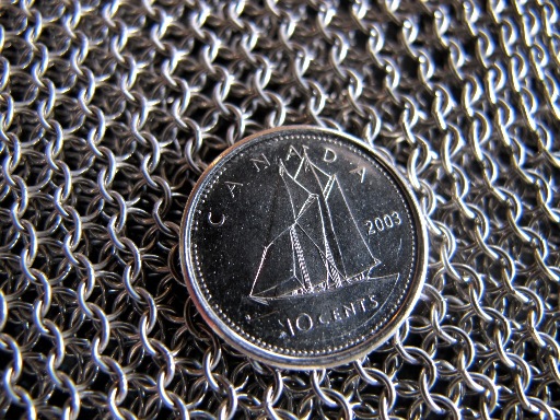

I have three sets of chain-mail butcher clothing.
These were originally used by cattle butchers.
I found them in a box at the metal recyclers in my area. (bought as scrap metal)
I paid $10 for the entire box of chain-mail. (for chest/legs and one arm protection)
So, check your local butcher supply outlets for this sort of gear.

Otto Nobedder wrote:Joe, If you want perfect protection, go to your nearest "renaissance fair" and buy a chain-mail jacket/vest from the "armourer", and rig up a way to clamp it to ground. Then, you're wearing a "Faraday cage" (google it), and are protected.Steve S
- Chain-mail.jpg (55.14 KiB) Viewed 11871 times
- Chain-mail2.jpg (135.13 KiB) Viewed 11871 times

Some great ideas here. I am trying to set up a test with one of my neighbors to see how good the mesh shielding works. The butcher chain mail looks promising. I have 2 neighbors that work for Honeywell and know how to set up the test. Thanks for the input.
