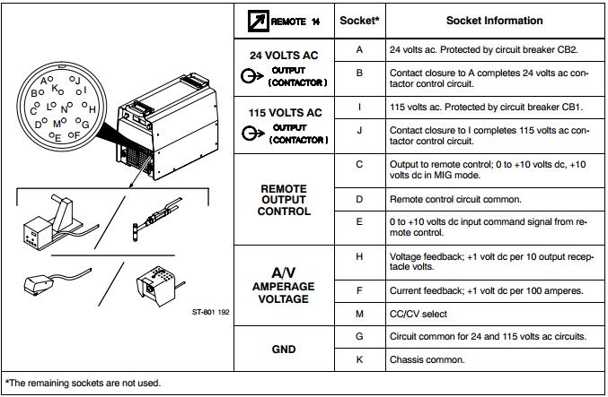

Can I use a Miller PC 300 Pulse DC/AC TIG Control with my XMT 304 cc/cv :?:

That's a good question!
I'd think it'd take some research to try it...
Are the pinouts the same? Are the control currents the same?
I'd have to dig up the specs of each, and probably spend hours digesting them to try to answer.
In general, Miller and Lincoln have standardized pinouts for connectors, meaning I've successfully used a Miller pedal on a Lincoln TIG, and vice-versa, but those are simple voltage dividers.
Sorry, that was no help...

Thanks Steve,
At this point, I'll no doubt contact Miller and see what their techs have to say.

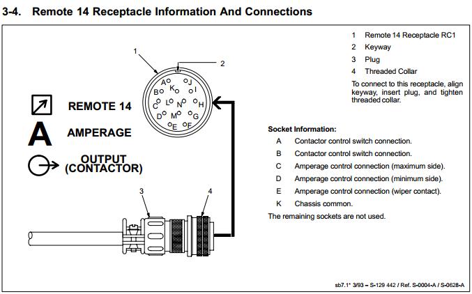

    Tue Jun 26, 2012 8:05 pm
YES, it can. The pinouts are the same on both units.
http://www.naalive.com/cataloglistingit ... id=1745473
Attached are the manuals for both units.
http://www.millerwelds.com/om/o898d_mil.pdf
http://www.millerwelds.com/om/o233045g_mil.pdf

Thanks a million for the tech info;it made my decision easy!
