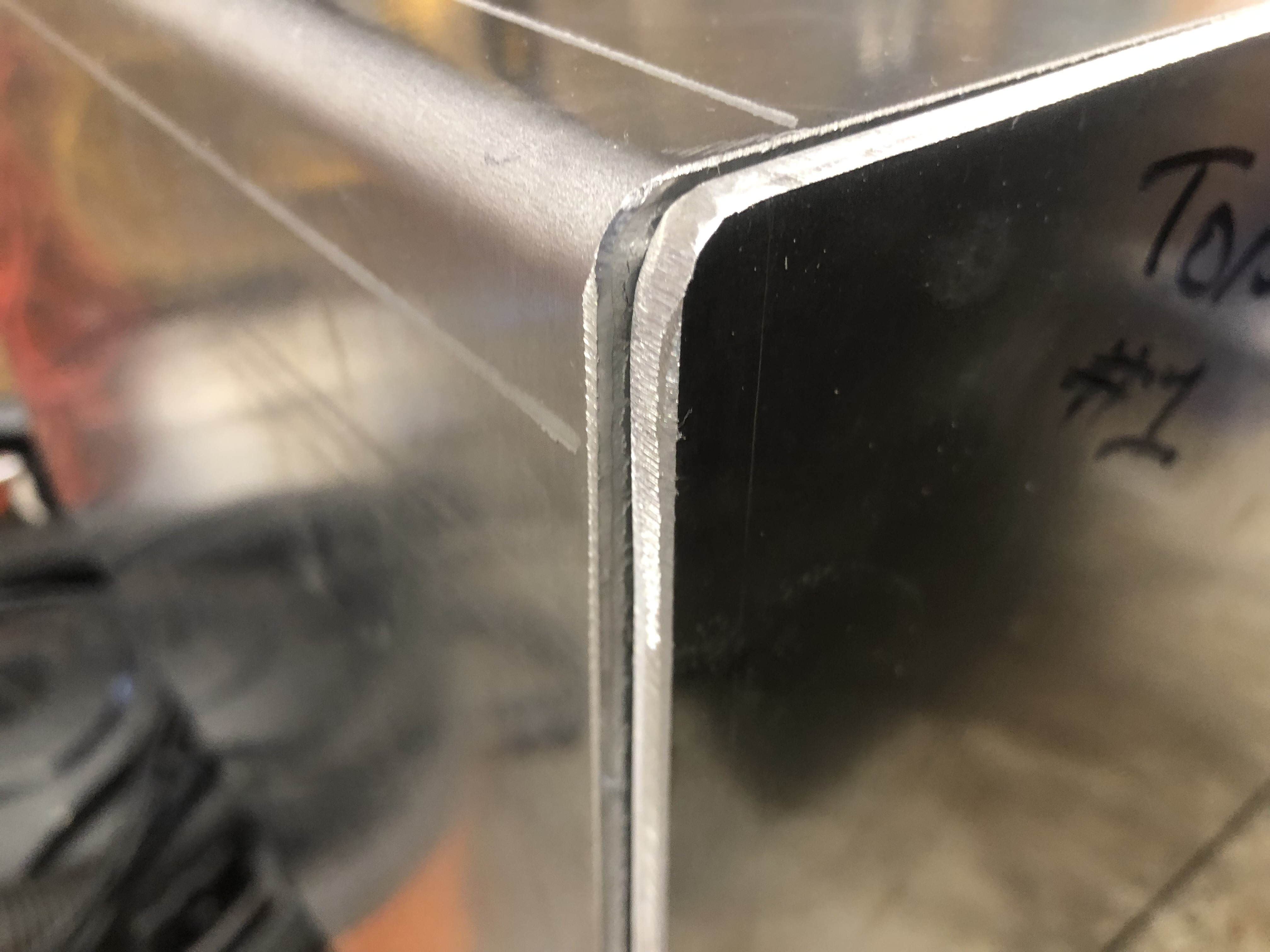

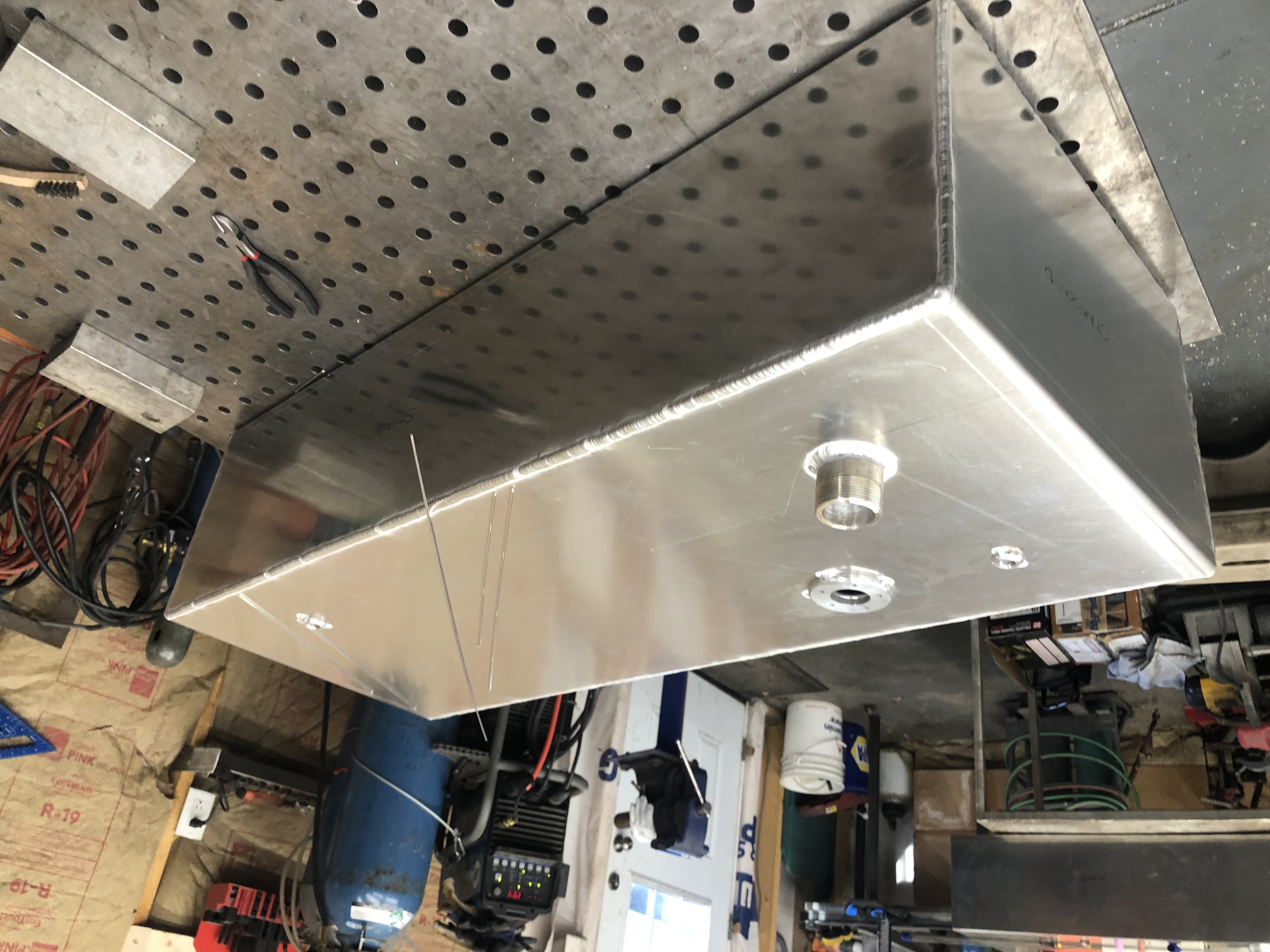

I’d use 5052 sheet, have as many edges broken using a Break, and weld up the rest. Internal baffles are a very good idea. And if possible, I try to weld the insides and the outsides for added strength. 1/8” filler with 3/16” sheet should be all you need.

- IMG_1013.jpeg (1.85 MiB) Viewed 20999 times
- IMG_1017.jpeg (2.15 MiB) Viewed 20999 times
- IMG_1018.jpeg (1.52 MiB) Viewed 20999 times
