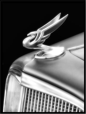

I'm restoring a 1934 Chevrolet Master Sedan as a hobby. A few days ago, I won the $14 bid for a rare print of this vehicle and tonight I won the $46 bid for the very rare hood ornament. I got the hood ornament really cheap, because the beak is broken off.
I was initially thinking of using JB-Weld for the repair and use it like modeling clay. I plan on casting more of these ornaments from the original, mostly because they are so rare and also because thieves love stealing these things. It wouldn't hurt to have a few spares kicking around.
Anyway, has anyone tried repairing these rare hood ornaments by building up the missing piece with weld, and then sculpting it back to original shape? I have attached a few photos to help clarify what I am talking about.

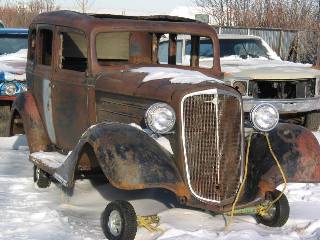

As far as the car itself goes, it will be a long road ahead, with lots of welding along the way. It has a very good frame and body. I have all of the glass, door knobs, window trim, brand new radiator, etc. No motor, no transmission, no suspension, no axles. Most restorers are using the Mustang II front suspension. I plan on making this car into an electric vehicle with a diesel/electric hybrid trailer for cruising long distances. It will have a modern day suspension with air ride.
Its unaffordable to restore to original, so it will become a project that is both from the past and the future. For anyone considering a project like this for profit, don't even think about it. These projects are a money pit and only done out of love for a certain type of vehicle. Its a hobby and nothing more. Attached is a photo of the car at its starting point.

Every time someone has brought me something like that, it ends up being pot metal. Strike a light arc on a hidden area. Cool car.

I talked to a guy some years ago that does 3D / 5 axis milling. He could make a mock-up off of your picture that you could use for a mold to cast more. He did beautiful work and can mill just about any material you could think of to make them out of. If you want, i'll try to find his name and number.

On a high-end car like that, it could be aluminum, but Jeff's right. Do a discrete test to be sure.
Steve's got a great idea, though. With the original for a model and a picture to fill in the blanks, this could easily be reproduced without risk to the original.
If it IS aluminum, I've done build-up/reduction before, but it won't be easy, as it's likely cast. It's a job for a specialist metal artist, if there's any real value to a fully restored piece.
2 cents...
If it's not worth more than $100 if fully restored, and it IS aluminum, give it a go, but I'd follow Steve's suggestion first, and get the 3-D model before messing with it.

The broken beak portion of the hood ornament is very small.
This is confirmed by looking at the Design patent drawings.
There are several suppliers of zinc die cast repair rods.
I have found some that I might try.
http://muggyweld.com/?view=potmetal
https://www.youtube.com/watch?v=Sh5W0xbZ9es
My Meco Midget oxy/acetylene torch will come in handy for this repair.
The other idea, is to use JB-Weld putty and sculpt the beak.
The original only has to be smooth enough and strong enough to make a cast mold.
Then, I can make as many copies of the original as I wish.

Neat project. The trailer will basically house a DC generator for the cars battery pack?
To replace the missing beak from the hood ornament, I've decided to drill a small hole into the head, then tap it and insert the threaded rod portion of a small bolt. I will then use this threaded post to attach my weld build up and then shape the beak with some small files.
