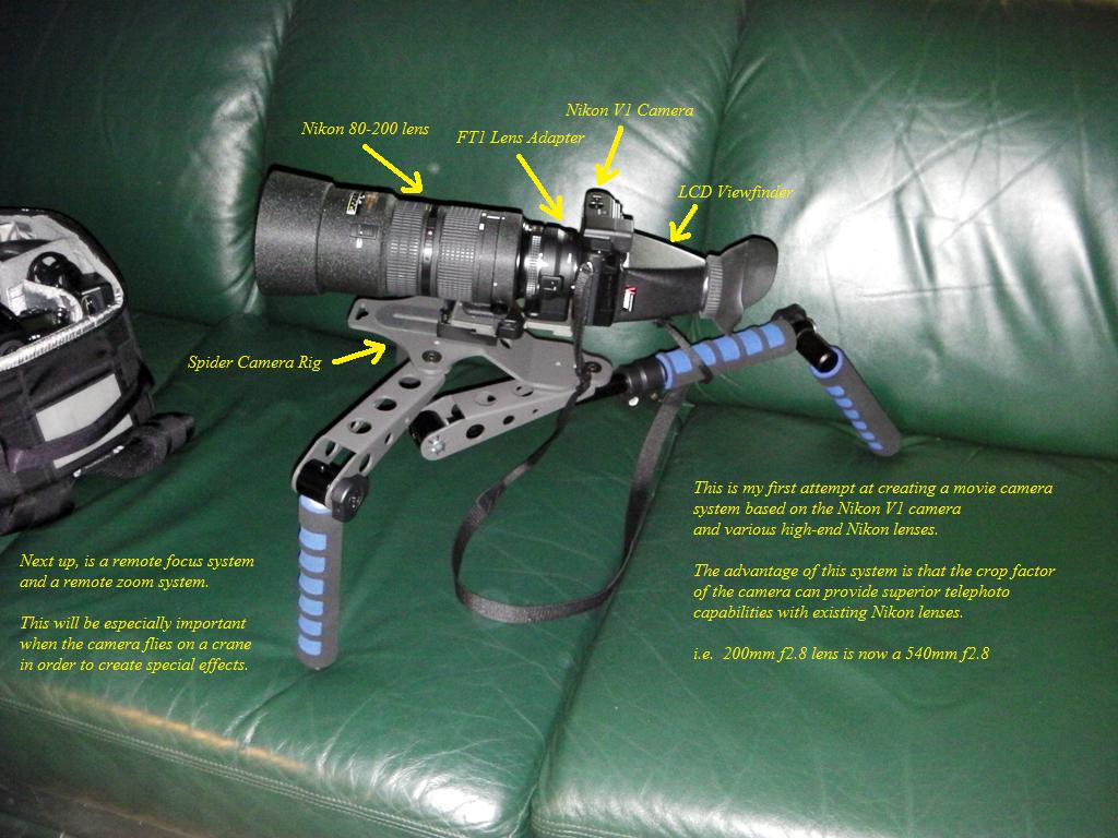

I have no experience shooting welding videos.
The Nikon V1 camera can shoot 1200fps in lower resolution.
http://www.youtube.com/watch?v=3A2X6jlVxDs
http://www.youtube.com/watch?v=nTwvfjbNnk8
The crop factor of this camera allows better zoom range with standard lenses.
i.e. 50mm X 2.7 crop factor = 135mm mid range zoom (with no loss of light).
i.e. 200mm X 2.7 crop factor = 540mm long range zoom (with no loss of light).
This is a paparazzi's dream camera. http://www.youtube.com/watch?v=l0AYjibuXoM
While people are seeking faster glass, Nikon has solved the problem in a different way.
An optional LCD viewfinder 3X loupe will allow you to see absolute focus.
Even if you have to fabricate this loupe to save money, it's worth the investment.
http://marvelsfilm.files.wordpress.com/ ... d_50mm.jpg
Fit the camera with an auto darkening welding hood shade.
Attach the camera to a tripod and set the focus.
The camera can be operated by remote control.
- My Camera Rig.jpg (134.11 KiB) Viewed 1550 times
