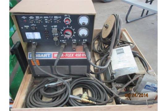

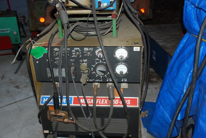

Here's a 650 and a 450, very similar.

Coldman wrote:Here's a 650 and a 450, very similar.
Its hard to see in the pictures, does the amp guage on the 450 go to 800 like it does on the 650? Judging by the width it looks like I've got myself a 450.

Here's a better pic cf the 450 showing the DC amp gauge scale to 800 amps. Or at least I can zoom in on the the pic prior to uploading and read 800amps clearly. If you PM me your email I will send you the original pic.

Coldman wrote:Here's a link to the pic
https://www.google.com/url?sa=i&source= ... 6846288031
Thank you buddy! It's a 450 for sure. Time to get some wiring done in my shop and install this old girl!

Here's a better attempt a gauge resolution:
