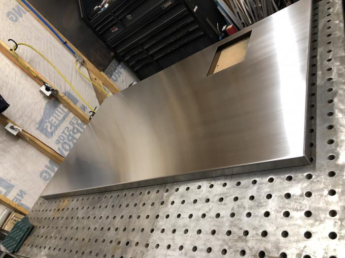

I found a guy on Etsy that makes this style of door and asked him what the edge looks like and he sent this picture:
He also said, “It is softened.”
Any idea what that means?

Like with an angle grinder?VA-Sawyer wrote:I'm guessing that it means he rounded over the outside edge of the sheet metal.

I took it that softened referred to smoothing the edge of the sheet metal. It could also mean the square tubing came with rounded corners vs. square ones.
To ease the edges of the sheet metal, I would use a file, or maybe a Scotchbrite disk. I would do it before welding the sheet to the frame.
Looks a lot more like that skin is bent on a sheet metal brake. The corners I’m sure are welded and ground for finish. Have done it with stainless sheet many times for counter tops.
