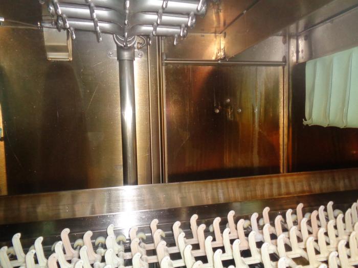

Sorry it took so long to get back to you guys.
Interestingly enough, only the 2 last rinse tanks are what's affected, nothing else.
The way the machine is laid out, left to right.
Load, 120-140*F Scrapper, 120-140*F Scrapper, 150-165*F Wash (detergents), 160-180*F Rinse 1, 160-180*F Rinse 2,185*F - 200*F Final rinse (a sanitizing spray), unload. The end.
The 2 rinse tanks are turning gold.
Hopefully this gives you guys some idea of what I'm seeing.
- Door, you can see the line where the gold ends.
- DSC07873.jpg (30.95 KiB) Viewed 2547 times
- Interior of the machine
- DSC07876.jpg (47.55 KiB) Viewed 2547 times
- Interior of the machine where you can also see where the gold ends.
- DSC07877.jpg (42.36 KiB) Viewed 2547 times

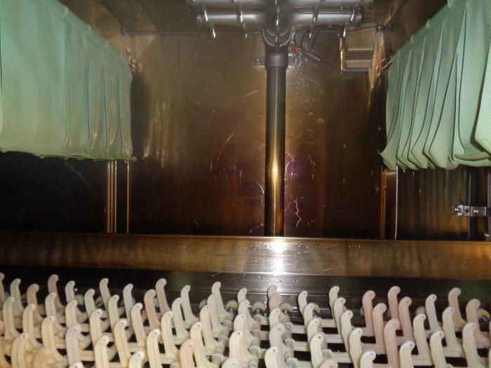

- Interior, gold
- DSC07878.jpg (50.59 KiB) Viewed 2547 times

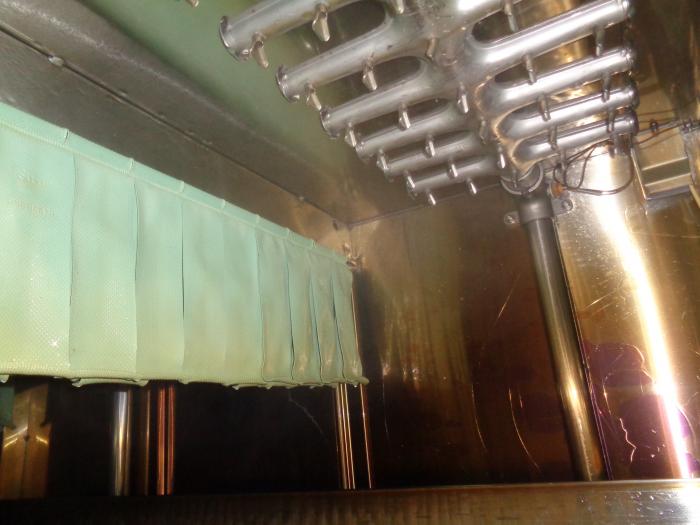

- Interior ceiling of one of the rinse tanks.
- DSC07881.jpg (44.54 KiB) Viewed 2547 times
They apparently tried delimer, soak tank and some other chemicals used in the kitchen, nothing worked.
I just went and tried delimer myself, doesn't do anything. It REALLY looks like a heat tint, but how did it get there? Temps are nowhere near 500*F, all kinds of stuff would melt before we got there.

What you are seeing is iron in the water that is depositing in the machine. Only one product that I know that will remove it and its called “ultra lime away” from ecolab, in a machine that large you might need up to 1/2 gal per tank, let it run for 15-20 mins. The final rinse end will most likely need to be done manually, put it in a bottle and spray it on, rinse it off. The discoloration wont affect the machine, or sanitation, its just cosmetic. I see this on a daily basis. If you need a contact to get some let me know and ill get you connected with someone.Olivero wrote:Hey guys.
