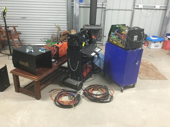

Well, electrical and plumbing all done, just need to finish off plaster for the toilet. Haven’t started benches yet, thought I’d have a maintenance day on the machines.......hf has been a bit lack lustre on the tig, the points were super tight, probably around .010-.015” so reset and a good clean and dust. My mig has been out of action for a while now, looks like the solenoid relay on the pcb, so removed that and get that repaired this week. Started the “modular” pedestal..... only had a stick welder on the plasma cutter to use......it has been a while!!!!!!!!
