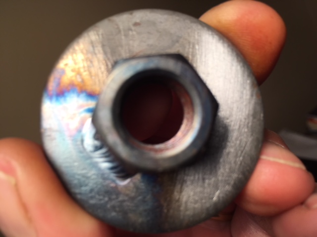

I have read a few post on this forum about removing galvanizing before welding. Soaking in cooking vinegar works but takes days to remove hot dipped galvanize. Other acids are just to strong and dangerous for my liking.
I have just learned that vinegar comes in different strength up to 30%, cooking vinegar is only 5%. I got a jug of 30% and tried it out 12 hour rather than 3 days to remove hot dipped galvanize from this nut and washer. Still not real fast but a lot safer no major safety warnings on the bottle.
Photo shows a nut and washer that were galvanized. The grey section is how it came out of the soaking, the bright section after a hand wire brushing, and the weld. I did not see a hint of zinc while welding

Where did you find the 30% vinegar. Been looking for 20-30% vinegar and haven't found any locally (Middle Tennessee).

Vinegar is an acid and as such, it will eat whatever is in it's way indiscriminately. So, if you leave the steel parts immersed too long, you won't have anything left to weld.
Something cheaper and far more effective is The Works toilet bowl cleaner. It will strip rust and galvanizing within an hour or so. Then eat your part. It runs about $2-3 for small bottle. You can also find Zep Toilet Bowl Cleaner by the gallon in the local Home Center, in the paint/chemical aisles. You can use it if you need a larger tank to soak in.
Both require cleaning of the parts afterward before welding.
Mpete if you end up using the Works, at least you can use the 30% Vinegar as a non selective weed and grass killer
make sure you use gloves and eye protection any vinegar above 10% can burn the skin.
