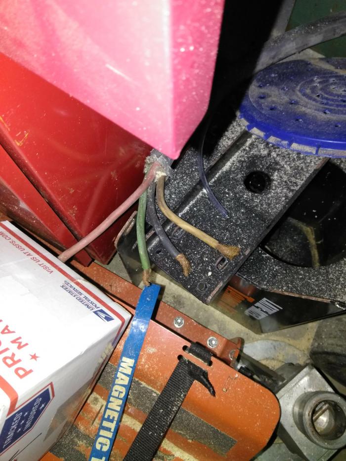

I have a beginner question, I bought a used idealarc 250 thats in almost new condition for a steal price from a prison shop and Im looking to get it running. From what I can see it was hardwired in their setup, and Im looking to get it back to plug in for 220 so I can run it at my place for repairs and fabrication. Its the 60hz version and Im trying to figure out exactly what I need to get it online, as Im heard different things from some people on the electricity requirements on it and this being my first welder I really am not familiar with what it needs. Im hoping I can just get a 220 50 amp plug wire it up and have it running but want to know for sure. So if anyone has advice I'd love to hear it, I'll also include the info plate and what the cord currently looks like.

- Welder's leads from the cord
- Welder 2.jpg (106.61 KiB) Viewed 6020 times
- Welder info plate
- Welder.jpg (101.51 KiB) Viewed 6020 times

While the above is possibly correct and a very common way to wire that, I would check how the wire is landed inside the welder to confirm the correct wiring on this machine

The machine is capable of 3-phase power, and since it came from an institutional setting it may have been supplied with 3-phase. I'm not sure how the machine is set up or configured for 3-phase vs. 1-phase- possibly with jumpers or bus bars inside the machine?- but it may be worth a look.
Wiring a new plug should be according to code, you can buy the plug to match your receptacle and after a web search attach the red/black/green accordingly.

I see nothing on the nameplate indicating three phase power. It looks to me like primary amps at 230 Volts is 86. At full output I read it as 30% duty cycle. Table 630.11(A) shows .55 as the multiplier. 86 x .55 = 47.3. A 50 amp plug will work. I would use at least #6 copper, if for no other reason, it will give you good voltage, fit the terminals, and reduce the risk of burning a terminal. A 90 amp breaker would be my choice to start. Up to 160 if needed, but it won't be needed.

It's a 1 phase and was attached to 1 phase at the place it was bought, side plate says 1 phase 60hz from what I made out. I think factory they came with a 220 50amp plug but I wasn't sure on the difference between the 50hz and 60hz versions. Thanks for the link on the manual, I'll be sure to check it out

Looking at the nameplate, it appears to be a single Ø machine.
It is also DUAL VOLTAGE 208- 460.
While attempting to power the machine from 208 won't hurt anything if the machine is connected 460, it certainly won't power the machine properly.
Forget about wire colors.
Open the machine and check the voltage selection first. Then determine what color wire is connected to which terminal and wire the plug appropriately.
There should be a wiring diagram inside the cover, and you can also get it from lincolnelectric.com with model and code numbers.
