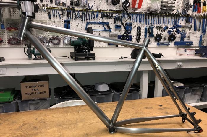

Thanks for your support and interest. Here is a brazed 4130 chromoly hardtail set up for disc brakes that can fit both a 31.5" X 5.05" tire and a 70 tooth chainring. This frame will serve as a bench test rig for the electronic systems (motor, controller, display, battery, throttle, multifunction switch and harnesses) for https://police-ebikes.com/. As such, it has eight mounts for multiconductor cables running down the top tube. It is at the powder coater now.
The front triangle is as large as one can make it; I have a 32" inseam and I can barely stand over it. The area inside the front triangle is valuable real estate for people who like to put large items in water bottle cages.
