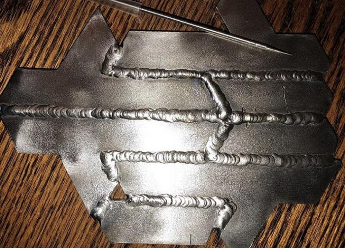

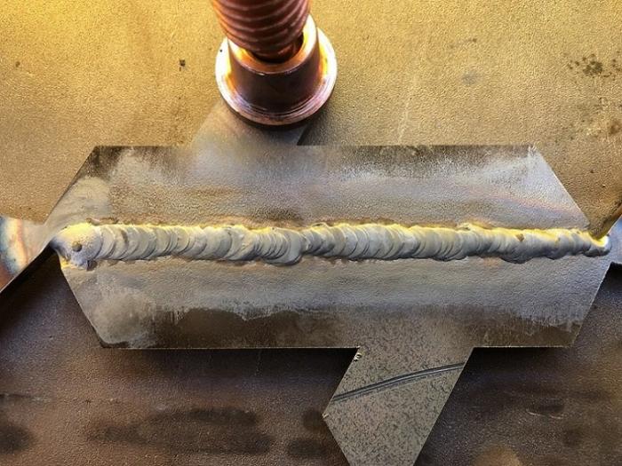

Here is a TIG bead from today. This is after about 15 hours of TIG hood time. I use 2% lanthanated 3/32" electrodes and 1/16" and 3/32" ER70S-2 filler. I had the machine set to 150A for this 3/8" steel plate. I made sure that the material was very clean. Also pictured is my setup. I like the Miller Small Runner Cart. It has a nice holster for the foot pedal. I have two Q size tanks because it is hard for me to get to the LWS due to my work schedule.

The man who does all my aluminum, 98% with a Cobra MIG rig on a Trailblazer power unit did probably half of the custom pipe hookups that went to the Winter Olympics in Italy, so he knows what he's doing. Danny's reputation leaked into the bike world, and the aluminum recumbant subset were lining up waiting for Danny to get there. He did quite a few and some people got the idea Danny needed their business so he'd dance to their tune. Their failure to understand Tuesday and COD resulted in Danny never touching another bike.
I see the problem with your shop instantly in the bench picture. That flat gray material is for driving on, and must be covered to become a welding shop. OK, really you just need more learning time, you'll get it evened out.
Remember to ventilate the welding shop, Argon is toxic.

I got in a good 9 hours of welding practice today. The TIG is going very well, but I have had very little success with stick. My SMAW is just a mess compared to the TIG. My cheap Harbor Freight 7018 electrodes get gummed up between passes, requiring a trip to the grinding wheel in order to expose the steel 7018 core for conductivity. I even managed to burn a hole in my new welding curtain when I set down the 7018 electrode.
My TIG practice really improved after an internet friend shipped me "a load of mild steel pickled and oiled laser cut drops". I had been using 16 gauge sheets of "welding steel" that I bought from the hardware store. That was frustrating for this beginner because I would burn through the sheet sometimes, particularly at the edges. I had been mostly laying beads on sheet metal (as opposed to welding joints).
A welder buddy (50 years experience) recently stopped by and told me to practice on actual joints. He also recommended that I not flatten (i.e. blunt) the end of my tungsten; I had been using a 30% angle on my Piranha 2 sharpener; he had me change that to a mere 10 degrees. I will upload a picture of the long, sharp tungsten tip that he recommended. It worked really well for me. He also recommended about 7/16" stickout with a #8 (gas lens) cup! I did not go to that extreme, but I did increase my stickout to about 5/16".
What really helped my practice was that I started to make a "tray" for my wife which is basically a lot of small pieces welded together. I am carefully fitting and cleaning them. After each new piece is welded in, I press the weldment at up to 5000psi in a hydraulic press to keep it flat. My motivation for making the best bead that I can is to please my wife. I am prepared to grind down and redo 100% of the beads if necessary. I will upload a picture of this "tray" in progress.
In the future, I will practice with actual (useless practice) sculptures in order to keep my work presentable (if possible) and have a reason to get great fitment and very clean surfaces.
Here is a picture of the extremely sharp tungsten and the practice weldment in progress:
- IMG_0746.JPG (93.77 KiB) Viewed 44151 times
