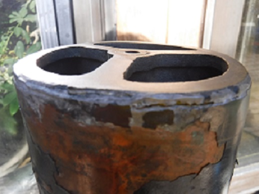

Due to a recent deep freeze and failure of engine heater are boats heat exchanger developed a small crack. I was curious what might be the best way to repair this unit.

If I'm looking at that picture correctly? Then that outer wall must be 1/4 or 3/8 thick? End plate looks to be the same. If it's a single wall I.E. pipe with a plate welded on the end. And the thicknesses are approximately between 1/4 and 3/8. And it's steel? A lot of assumptions on my part. I'd grind out the cracked portion of the old welds until the crack is gone and then stick weld with 3/32-7018 or Tig with 70s2.w123turbo wrote:Due to a recent deep freeze and failure of engine heater are boats heat exchanger developed a small crack. I was curious what might be the best way to repair this unit.
