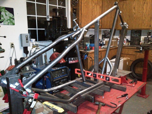

Hey welders! I'm a noob to the forum. I've been visiting WTT for around a year, maybe a little less, and really enjoy Jody's videos. They have helped me a lot with learning TIG welding.
I am building a motorcycle frame now, a Harley chopper frame type. It's the second frame for me. The first one I welded up with a MIG, a Lincoln 155, but for the second one I wanted to TIG weld it. I bought a Miller Syncrowave 200 a few years ago and after moving across the country, finally got my shop set up again and started practicing. For the frame I'm using 1.25" .120 wall CREW round tube which is not DOM or cromo, just mild steel. I have a JD2 bender and I've been using a tube mitre program to make patterns for cutting the copes. Anyway, welding round tube with coped fit ups at angles less than 90 degrees are difficult for me with the TIG and I would love to see some topics on this kind of thing, or videos from the master! I have really liked the bicycle frame vids and I have found some other videos where Jody has discussed this type of welding of coped round tube jobs.

- Frame tubing bent and coped in jig fixture
- IMG-20130218-01027.jpg (111.68 KiB) Viewed 5531 times

Welcome cyclhed! Always good to have someone with shared interests around.
"welding round tube with coped fit ups at angles less than 90 degrees are difficult" One way to "get in there" that works well is to build an aluminium foil argon dam behind the area your welding so you can extend your tungsten enough to reach the joint. That and I use a #4 or #5 cup with 3/32 electrode. <read, think cheap, small and steal the Ole' Lady's tin foil>
Just don't wrap the foil to tight against the weld joint, leave kind of a bowl to hold the gas...tin foil vaporizes really fast with a tig arc, don't ask how I know.
Another option would be to use a gas lens but I don't have one for my torch, maybe some day...I want to try one of these; http://www.usaweld.com/TIG-Pyrex-Cups-Kits-s/67.htm
It looks like your frame is coming along nicely. What "Grade" CREW are you using for your frame, 1018, 1020? DOM is over rated and $$$ for a bike frame IMHO.
Thanks Fat Bob. One of my favorite videos is this one where Jody shows the tin foil method: http://www.weldingtipsandtricks.com/welding-4130.html
I know the video is for 4130, but the joints are what I'm focusing on there.
I've been practicing on some 40 degree joints. Yesterday I tried a 1/16 electrode, #7 cup, 140A, 15CFH, 1.3 PPS with both 5/32 and 1/16 ER70S2 filler rods. I worked pretty good and I got a fairly decent looking weld. The 1/16 rod had some undercut. The problem with these joints is the different type joints around the tube so I need to adjust for that. That seems to be where I'm either too hot or not hot enough. I think the key is to adjust properly for the different conditions when I get to them.
The tubing I have is probably 1018, but I don't know for sure. I bought it 8 or 9 years ago in Atlanta when I lived there.
