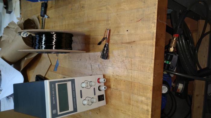

sorry for the delay , been very busyweldin mike 27 wrote:Thanks Kevin. Much appreciated
30v 10 amp dc cc CV power supply
the carbon tow is from Fibreglast.com
when I have more time I'll post more info and maybe a video

Kevin and Brian, Any chance you have a picture of your home made tig brush? Would a battery charger work as the power source? Any details or pictures would be helpful as I'm trying to pass on to a contact. Best, Mick Hi Mick give me another week and i can post all the pics and info i have , i have ...

But without the purple cows & cuckoo clocks ! All joking aside dilute phosphoric acid & 25 > 30 volts works just fine & easily washes off & will not eat you ! thought i was the only one who used that , bought some carbon fiber yarn and some 14g wire and made up a brush i add some ci...
