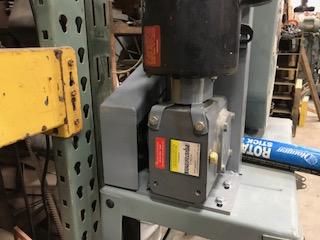

Re: Converted wood bandsaw for metal
got the guards done. cuts steel like butter.
- IMG_0480.JPG (29.81 KiB) Viewed 1982 times
- IMG_0481.JPG (31.46 KiB) Viewed 1982 times
- IMG_0482.JPG (61.04 KiB) Viewed 1982 times
Today I converted a Delta 14" band saw for cutting metal. stock the blade runs at about 2900 sfpm now i have it running at about 210 sfpm. i added a 30:1 gear reduction box on the motor and played with the pulley sizes on the belt to reduce the speed. i just ordered blades for it today and i ne...
