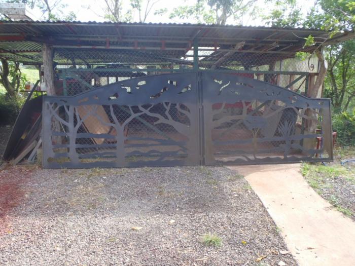

Re: Plasma Cutting Question
Final product. No fancy table needed (then)
- P4191189.JPG (71.96 KiB) Viewed 11327 times
