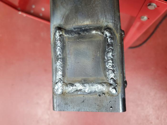

Re: Need to weld thin washers to 1/8in steel
I finished up most of the welding and grinding. Not super pretty, but structurally strong. I got a safety loop to weld on the bottom of the tongue, and then clean and galvanize.
Oh, ha, no I meant 3/32" 6013, at 65 amps.

I got half of it done last night. The first 8 plates are welded on. After a lot of playing around I went with 5/32" 6013 at 65 amps.
Here are a few shots. I know they aren't super pretty, but they will work.

20200207_172058.jpg Well I tried these 4 with the 1/16" 6013. Amps from 35 up to 60. I tried many different angles too. Other then straight practice beads, which I got pretty consistent at, this is the first real welding attept/project. Any suggestions are welcome. Should I try swapping to DCEN?
I'm really new to this and I'm trying to work out a problem. I got the welding set up (Everlast PowerTig 185) in part to finish a project on my trailer. I need to weld thin washers onto the sides of a 2x3x1/8". I'm not having much success on my practice piece. Everything I do seems to melt the ...
