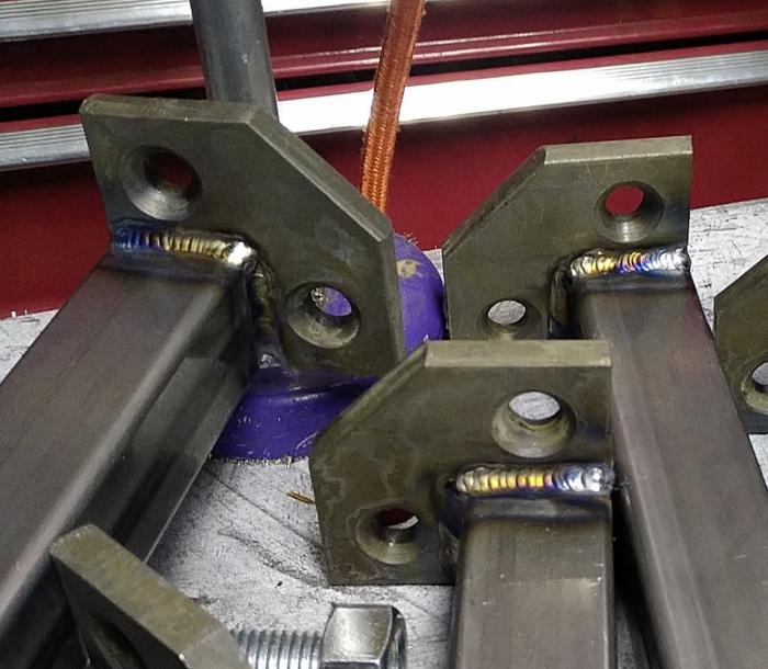

I like phosphoric acid. This is some brackets soaked in 21% mix after about two hours. 8mm hot rolled flat bar.
Welds nice and clean, no acetone just a quick rinse with water and let dry.
