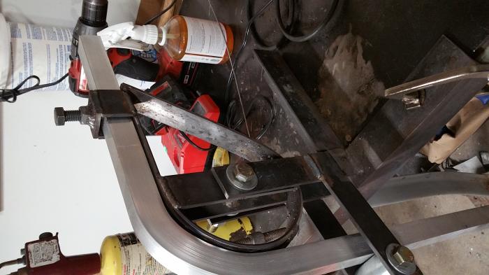

- by Mihtu
- Wed Mar 29, 2017 10:20 pm
- Topic: Tube bender
- Replies: 7
Re: Tube bender
Base for bench is 2 inch angle,you need an 8",and a 16" piece, the upright for axle are 8" also,the mandrel is a piece 24" long bent around a b-tank.then 2 pieces 6" long,I bent and welded the loop,then added in the 6" pieces, how I positioned them is put a level on the...

- by Mihtu
