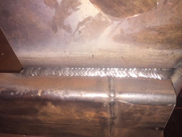

Re: One process to rule them all!
Here's the latest....multiple passes with one wide cover pass....
- IMG_7289.JPG.jpeg (41.88 KiB) Viewed 837 times
